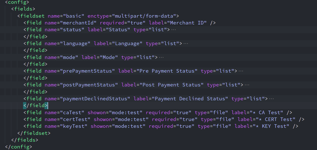

Hi.
I'm trying to make a payment plugin, this plugin has some custom fields I added manually in example.xml file.
Here is code how I added.

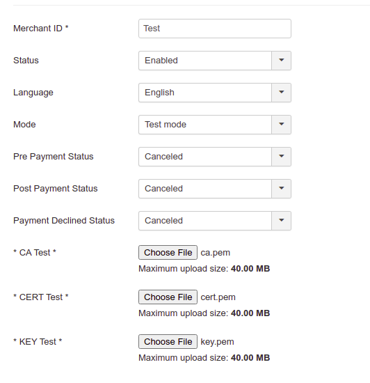

How it displays:
So far, everything is fine.
My problem is with last 3 fields, I can't accessing them correctly.
Access to the fields above them works perfectly, but with files it doesn't.
I am trying the code You provided like this:
This shows me only the name of the file I entered.
How it displays:
Code:
$plugin = JPluginHelper::getPlugin('hikashoppayment', 'example');
$this->params = new JRegistry(@$plugin->params);
echo $this->params->get('caTest');

It's normal you only get the file name with this.
You need to prepend the path of the folder where the file is uploaded.
Now I don't know where Joomla put the files uploaded with that type.
And it's not mentioned here:
docs.joomla.org/File_form_field_type
I would recommend to ask this on forum.joomla.org
Also, I would recommend to have these files in a folder not accessible by a URL. Otherwise, anyone would be able to download these files and they might be able to impersonate the merchant on their own website, or validate orders without any payment made.
