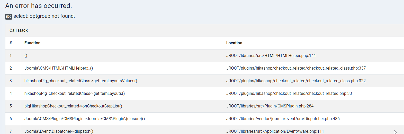

After upgrading to from J3 -> J4, I noticed many php errors when trying to access the HikaShop configuration. I was able to isolate it to just the checkout related plugin.
Please let me know if you need any additional information or backend credentials.
-- Joomla version -- : 4.3.0
-- PHP version -- : 8.1
Code:
select::optgroup not found.
3 years 5 months ago #351208
by Jerome
Replied by Jerome on topic Checkout Related Plugin - 500 error after upgrade to J4
Please re-download the plugin in order to have the fix.
We fixed that issue several months ago but it looks like we had an issue with the upload of the latest version.

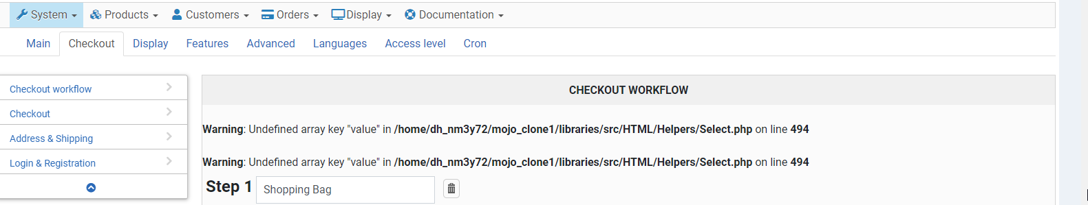

Thanks Jerome! After installing new version, i no longer get the 500 errors. However, i did see a php warning come up that i can toggle with the checkout related plugin being published:
Warning: Undefined array key "value" in ****/libraries/src/HTML/Helpers/Select.php on line 494

3 years 5 months ago - 3 years 5 months ago #351250
by mojooutdoors-holden
Replied by mojooutdoors-holden on topic Checkout Related Plugin - 500 error after upgrade to J4
Last edit: 3 years 5 months ago by mojooutdoors-holden.
3 years 5 months ago #351286
by Jerome
Thank you for the screenshot.
There is indeed an issue with the HikaShop core which cannot handle "groupedlist" content with Joomla 4.
One possibility is to modify the file "checkout_related_class.php" in order to replace the content
By
But you'll loose the "template" detail in Joomla 4.
The other possibility is to fix the HikaShop core in order to handle groupedlist for J4 ; or to add a new type of content specially for grouped lists.
Code:
$values[] = array(
'text' => $optGroup,
'items' => $ret
Code:
$values[] = $ret;

3 years 5 months ago #351399
by Jerome
I update the plugin with the corresponding fix.
It also contains the modification for "groupedlist" in HikaShop checkout workflow system.
Thus, it requires a small modification in the current version of HIkaShop (until the next release which will include the patch).
File : "administrator/components/com_hikashop/types/checkout_workflow.php"
Replace
By
Replace
Code:
case 'list':
if(!isset($s['values']))
break;
$ret .= JHTML::_('select.genericlist', $s['values'], $name, 'class="inputbox no-chzn" data-checkout-param="'.$k.'" onchange="window.checkoutWorkflowEditor.onChange(this);"', 'value', 'text', $v);
break;
Code:
case 'list':
break;
break;
case 'groupedlist':
break;
if(!HIKASHOP_J40)
else
$ret .= JHTML::_('select.groupedlist', $s['values'], $name, array('list.attr'=>'class="custom-select" data-checkout-param="'.$k.'" onchange="window.checkoutWorkflowEditor.onChange(this);"', 'group.id' => 'id', 'list.select' => array($v)));
break;
