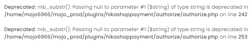

I should also note that i'm also exclusively using the Authorize.net payment plugin that has a few deprecation warnings, but nothing that appears to be critical:
