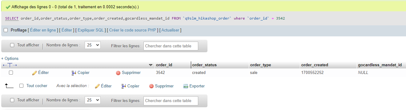

  • Posts: 28
  • Thank you received: 5
  • Hikaserial Subscription Hikashop Business
2 years 10 months ago #356794
So I just did. Here is the modified order.class :
		$old = $order->old;
		unset($order->old);

Here is the result of the query in phpmyadmin :
just after the parent::save(), all the three "go_cardless_xxxx" custom fields are set to null. None contain the right value...

Edit :
Reading back my message, I've realized that in my code the variable is
$orderObj->goCardLess_mandat_id
with uppercases letters "C" and "L" where the column name in the database is "gocardless_mandat_id" all lowercase.
So, instead of throwing an sql error (column does not exists) it was silently doing nothing.
I guess in some previous version there was somewhere an uppercase to lowercase conversion which changed the real name so it was working.
It was on front of my eyes since the begining.... Thank you for the talk which drive me to the solution.
  • Posts: 86211
2 years 10 months ago #356799
Indeed, reading your last messages and seeing the screenshot of your PHPMyAdmin, I directly saw that the problem was with the case of the attributes and I was about to write about it :)
It's great your found the problem.
It could be that Joomla changed the way it process upper case characters when generating the MySQL queries.
The following user(s) said Thank You: gvitry
