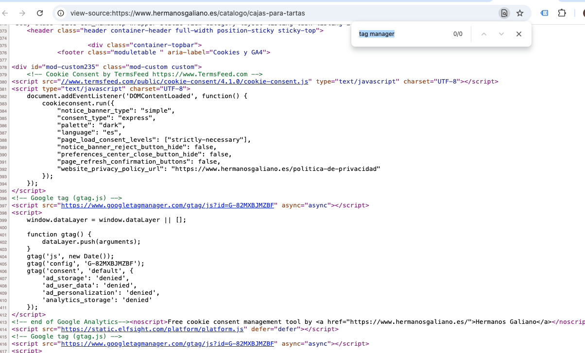

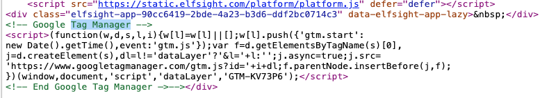

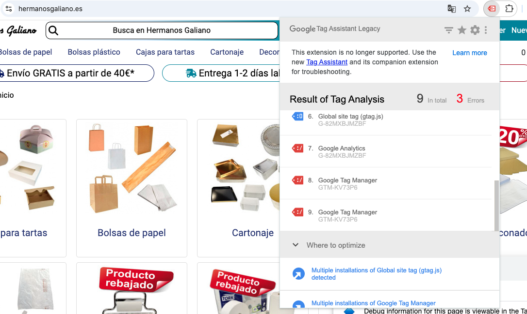

I’m attaching the 3 screenshots they sent me.

All the javascript code on your screenshots are not from something we developed on our end as far as I can see.
It must have been added on your end via other joomla plugins or components or the template, or some customization.

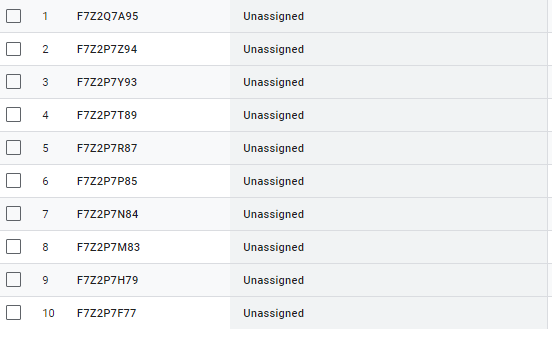

Last night, I tried making a purchase via CPC (order F7Z2P7Z94).
Later, I spoke with a customer who had items in her shopping cart, and she told me she accessed the site via organic search, looking for Hermanos Galiano on Google (she completed order F7Z2Q7A95).
In both cases, they were assigned to the UNASSIGNED channel.

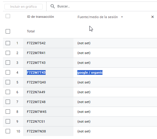

Hi Nicolas.
The purchase nº F7Z2M7T43 has been asigned google / organic
I attach screeshoot.

I’m attaching a screenshot of the latest orders, where all are marked as unassigned except for 72850 and 72829. At least 72850 appears in the log.

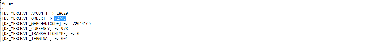

Hi!!

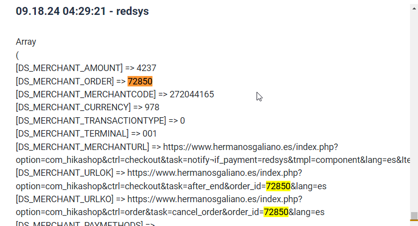

If necessary, I have a payment log file (.txt) in which the details of order 72743 (which was assigned as Organic) are visible.
If it would help you, you can let me know an email address where I can send it.
I'm attaching a screenshot of the .txt file.

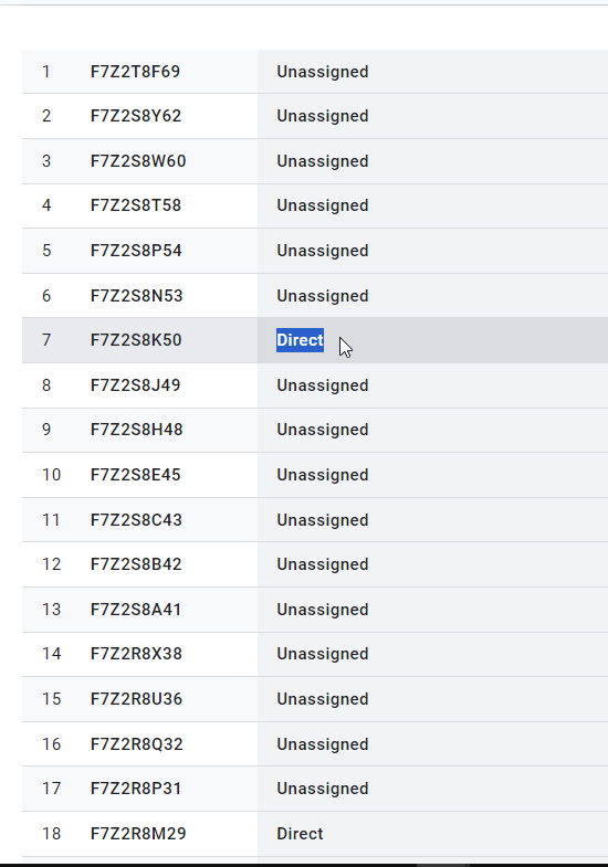

1 year 11 months ago #363321
Hello Nicolas,
I'm not sure if you've been able to check anything yet.
I'm concerned about not having accurate tracking for my ADS campaigns.

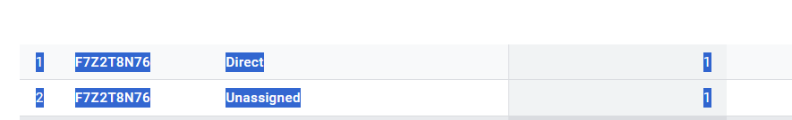

In GA4, I'm seeing that the same order number has two default channel groups.
Order F7Z2T8N76 shows both Direct and Unassigned,
and order F7Z2S8W60 shows both Organic and Unassigned.
I'm attaching screenshots for your review.
It's clear that we're missing something

You need to look for the order number in the log. The places where you see the order id are added by the payment plugin and are not related to the issue we're looking into here.
A main reason why the "unassigned" issue can happen is if the session_id parameter is missing:
stackoverflow.com/questions/77270569/ga4...results-in-source-me
I looked at the log for several orders and I can see the session_id and the client_id properly set in them.
Now, I can see that the PHP SDK sends the user_id and the timestamp_micros properties empty. Normally, it shouldn't matter.
Here is attached a new version of the plugin with these attributes provided. Install it to get the modifications.
