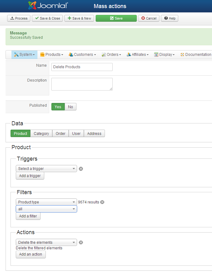

Hi, I have created a mass action, please see attached. It seems to only process about 1000 products at a time. So i click on process, then it will delete 1000 products. I will then have to ask it to process again for it to delete more products, even though i can see that it has found all the products according to the filter, is this normal?

12 years 10 months ago #125047
We have to improve the mass actions, actually you have to do many process.
It's already on our todo list. This should be in HikaShop 2.3.0.
