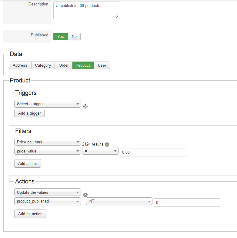

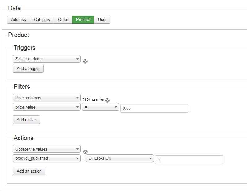

Hi, I need to run a mass action to set where the product value = 0.00 then its publishing state needs to be set to unpublished. I have tried a few combinations however i cannot seem to get this to work, would you mind pointing me in the right direction? I have done the following so far (attached).
Alex
  • Posts: 86077
  • Thank you received: 14186
12 years 9 months ago #132974
In the action, you shouldn't select "operation" but "integer".

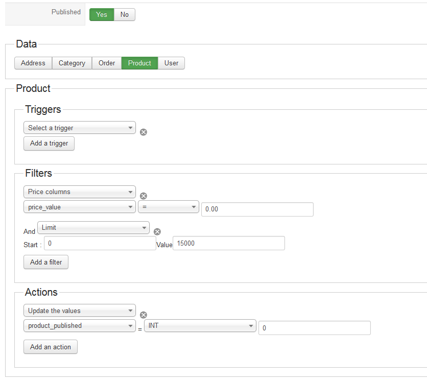

12 years 9 months ago #133109
Thanks i have approx 13,000 products so i set the limit to 15,000 to cover for future additions however now i get an sql error please see attached.

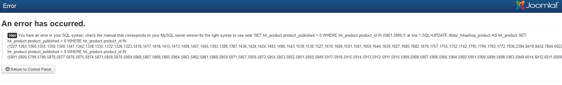

12 years 9 months ago #133229
This is the error:
An error has occurred.
1064 You have an error in your SQL syntax; check the manual that corresponds to your MySQL server version for the right syntax to use near 'SET hk_product.product_published = 0 WHERE hk_product.product_id IN (5801,5800,5' at line 1 SQL=UPDATE dkibz_hikashop_product AS hk_product SET hk_product.product_published = 0 WHERE hk_product.product_id IN (1227,1283,1360,1355,1350,1348,1347,1342,1338,1335,1332,1326,1323,1418,1417,1416,1415,1413,1408,1407,1405,1393,1389,1387,1436,1428,1424,1483,1480,1543,1539,1530,1527,1610,1608,1591,1581,1659,1640,1639,1627,1685,1682,1678,1757,1755,1752,1742,1795,1794,1783,1772,1936,2384,8410,8452,7804,6022,6023,6024,6025,7776,3242,3220,3213,3293,3292,3291,3282,3265,3327,3310,3410,3409,3406,3400,3394,3387,3384,3436,3428,3482,3478,3477,3472,3471,3541,3535,3532,3531,3597,3590,3576,3575,3568,3646,3639,3637,3628,3627,3702,3680,3679,3666,3748,3747,3745,3781,3780,3779,3777,3769,3842,3841,3834,3832,3831,3829,3825,3901,3900,3899,3898,3896,3894,3893,3889,3888,3887,3886,3885,3884,3881,3880,3877,3876,3872,3871,3866,3959,3956,3954,3950,3949,3948,3947,3945,3944,3940,3938,3937,3930,3979,3976,3974,3971,3970,3969,3967,3966,3965,4045,4039,4038,4032,4031,4030,4028,4067,4104,4086,4085,4084,4083,4082,4079,4155,4152,4151,4149,4148,4144,4143,4215,4214,4213,4212,4209,4185,4182,4264,4262,4260,4258,4256,4253,4252,4248,4247,4242,4237,4236,4235,4287,4284,4283,4281,4280,4279,4278,4354,4353,4350,4348,4347,4346,4345,4343,4335,4334,4333,4332,4330,4396,4392,4391,4385,4384,4383,4381,4438,4432,4471,4530,4525,4506,4505,4577,4563,5590,4609,4595,9551,9552,9553,4662,9554,9555,4740,4739,4738,4737,4734,4733,4732,4731,4730,4729,4728,4722,4779,4778,4777,4776,4775,4774,4773,4772,4771,4770,4768,4767,4766,4765,4764,4762,4761,4760,4758,4756,4755,4754,4751,4750,4747,4745,4839,4836,4832,5539,4828,4827,4826,4823,5541,4807,4805,4804,4803,4801,4800,4799,4798,4797,4796,4795,4881,4876,4873,4848,4907,4905,4901,4900,4899,4898,5006,5078,5077,5076,5075,5074,5073,5072,5071,5067,5066,5065,5064,5063,5062,5061,5055,5053,5048,5047,5045,5126,5125,5124,5123,5122,5121,5120,5119,5118,5117,5116,5114,5113,5112,5111,5110,5109,5108,5107,5106,5105,5104,5103,5102,5101,5100,5099,5098,5097,5180,5179,5178,5177,5175,5174,5173,5172,5171,5170,5169,5168,5167,5166,5165,5164,5163,5162,5161,5160,5159,5158,5157,5156,5155,5154,9615,9616,9617,5209,5204,5197,5332,6017,5310,5302,5296,5350,5414,5410,5404,5402,5396,5538,5523,5521,5519,5518,5515,5514,5513,5512,5511,5574,5573,5572,5571,5570,5569,5568,5567,5566,5565,5564,5563,5562,5561,5560,5558,5557,5556,5555,5554,5553,5550,5549,5548,5547,5546,5622,5621,5620,5618,5617,5616,5615,5614,5613,9186,5606,5605,5604,5603,5602,5601,5600,5599,5598,5597,5596,5595,5652,5651,5650,5646,5645,5722,5716,9758,5703,9452,5785,9470,5782,9471,5780,9472,5778,9453,9473,5772,5767,9415,5736,5755,5774,5747,5795,5808,5806,5805,5804,5803,5802)SET hk_product.product_published = 0 WHERE hk_product.product_id IN (5801,5800,5799,5798,5878,5877,5876,5875,5874,5873,5858,5870,5869,5868,5867,5866,5865,5864,5863,5862,5861,5860,5859,5871,5857,5856,5872,5854,5853,5852,5851,5850,5849,5917,5916,5915,5914,5913,5912,5911,5910,5909,5908,5907,5906,5905,5904,5902,5901,5900,5899,5898,5963,5948,6014,6012,6011,6009,6007,6006,6005,6003,6000,5999,6055,6054,7801,6052,6051,6050,6049,6048,6047,6046,7800,6043,6042,6041,6040,6039,6038,6037,6036,6099,6098,6097,6096,6095,6094,6093,6092,6090,6089,6088,6085,6148,6145,6139,6137,6136,6135,6208,6186,6249,6248,6247,6246,6245,6244,6243,6242,6241,6240,6239,6236,6235,6313,6312,6311,6310,6309,6308,6307,6306,6303,6302,6301,6300,6299,6298,6297,6296,6295,6294,6293,6292,6291,6290,6289,6287,6286,6285,6339,6338,6337,6336,6335,6368,6471,6545,6538,6536,6532,6524,6519,6516,6633,6632,6626,6625,6624,6699,6698,6697,6690,6689,6688,6687,6683,6682,6675,6674,6672,6671,6670,6669,6666,6735,6733,6729,6726,6725,6724,6723,6720,6719,6717,6715,6794,6793,6791,6788,6787,6786,6784,6783,6782,6781,6779,6777,6776,6774,6773,6772,6771,6770,6767,6833,6831,6829,6828,6827,6826,6825,6824,6822,6821,6818,6816,6950,6938,6967,7006,7002,6992,6985,6984,6980,7038,7037,7035,7034,7032,7031,7029,7023,7021,7020,7019,7018,7015,7098,7097,7091,7090,7078,7077,7075,7074,7072,7137,7215,7327,7325,7324,7321,7320,7378,7374,7373,7372,7370,7369,7368,7367,7366,7365,7451,7449,7448,7446,7445,7437,7436,7434,7430,7427,7426,7424,7419,7417,7416,7495,7492,7490,7489,7486,7484,7482,7479,7478,7474,7472,7471,7469,7468,7467,7466,7556,7554,7550,7549,7548,7546,7543,7538,7537,7536,7534,7532,7531,7529,7518,7517,7516,7515,7598,7597,7596,7595,7594,7593,7592,7591,7590,7586,7585,7584,7583,7581,7579,7578,7577,7575,7574,7573,7571,7570,7569,7568,7567,7566,7639,7638,7637,7636,7635,7631,7630,7629,7628,7626,7625,7623,7619,7618,7616,7615,8519,7747,7753,7754,7755,7756,7805,7807,7808,7809,7810,7811,7815,7816,7817,7818,7819,7820,7803,7802,7822,7940,7986,7821,8450,8449,8409,8408,8407,8650,8651,8658,8714,8707,8704,8703,8701,8696,8691,8686,8685,8678,8677,8766,8763,8761,8759,8739,8737,8730,8808,8806,8803,8800,8797,8790,8780,8777,8776,8844,8842,8836,8832,9183,9181,9180,9178,9177,9176,9210,9209,9206,9205,9204,9203,9201,9199,9198,9197,9196,9195,5638,5636,5634,5587,9254,9253,9247,9244,9239,9237,9233,9232,9315,9314,9313,9310,9309,9308,9306,9305,9298,9293,9291,9289,9284,9356,9354,9350,9349,9346,9343,9341,9340,9339,9337,9336,9335,9333,9414,9412,9411,9409,9408,9407,9405,9402,9400,9396,9391,9387,9386,9385,9384,9383,9382,9381,9449,9448,9445,9442,9441)
Return to Control Panel

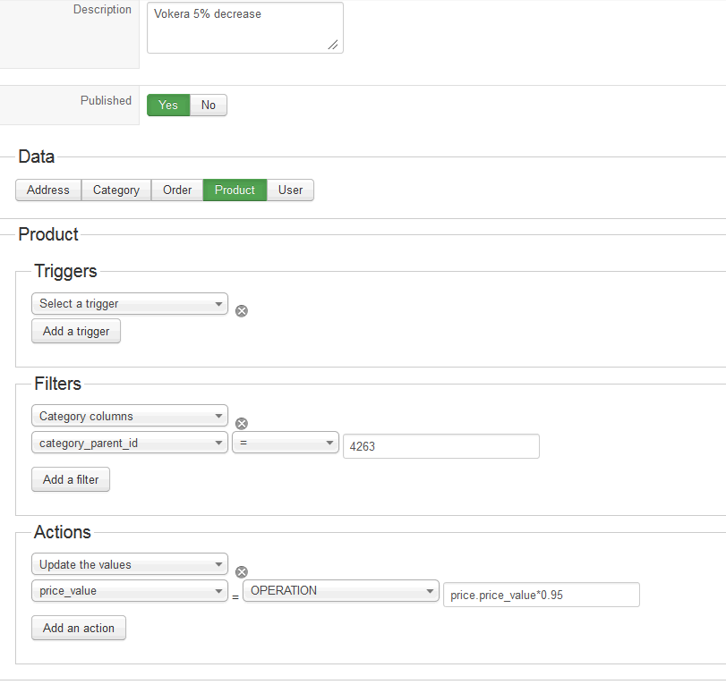

I also have another error when i try to run this mass action (attached)
This is the error for that one, i do not know if they are related or not. This is something that Xavier did resolve however when i updated hikashop it broke again and i dont have the file he uploaded so i might have to get that from a backup.
Error
1054 Unknown column 'hk_product.price_value' in 'field list' SQL=UPDATE dkibz_hikashop_product AS hk_product LEFT JOIN dkibz_hikashop_price AS hk_price ON hk_price.price_product_id = hk_product.product_id SET hk_product.price_value = 0 WHERE hk_product.product_id IN (5798,5799,5800,5801,5802,5803,5804,5805,5798,5799,5800,5801,5802,5803,5804,5805,5806,5807,5808,5798,5799,5800,5801,5802,5803,5804,5805,5798,5799,5800,5801,5802,5803,5804,5805,5806,5807,5808,5798,5799,5800,5801,5802,5803,5804,5805,5798,5799,5800,5801,5802,5803,5804,5805,5806,5807,5808,5798,5799,5800,5801,5802,5803,5804,5805,5798,5799,5800,5801,5802,5803,5804,5805,5806,5807,5808,5798,5799,5800,5801,5802,5803,5804,5805,5798,5799,5800,5801,5802,5803,5804,5805,5806,5807,5808,5799,5800,5848,5849,5850,5851,5852,5853,5854,5855,5856,5857,5858,5859,5860,5861,5862,5863,5864,5865,5866,5867,5799,5800,5848,5849,5850,5851,5852,5854,5855,5856,5858,5859,5860,5861,5862,5863,5864,5865,5866,5867,5868,5869,5799,5800,5848,5849,5850,5851,5852,5854,5855,5856,5858,5859,5860,5861,5862,5863,5864,5865,5866,5867,5870,5871,5800,5852,5872,5873,5874,5875,5876,5877,5878,5879,5880,5881,5882,5883,5884,5885,5800,5852,5872,5873,5874,5875,5876,5877,5878,5879,5880,5881,5882,5883,5884,5885,5800,5852,5872,5873,5874,5875,5880,5882,5884,5885,5886,5887,5888,5889,5890,5891,5800,5852,5872,5873,5874,5875,5880,5882,5884,5885,5886,5887,5888,5889,5890,5891,5800,5852,5858,5859,5861,5862,5920,5921,5922,5923,5924,5925,5926,5927,5928,5929,5930,5931,5932,5933,5800,5852,5858,5859,5861,5862,5920,5921,5922,5923,5925,5926,5928,5929,5930,5931,5932,5933,5934,5935,5800,5852,5857,5858,5859,5861,5862,5921,5922,5926,5929,5930,5931,5932,5933,5936,5937,5938,5800,5852,5858,5859,5861,5862,5888,5921,5922,5926,5929,5930,5931,5932,5933,5936,5938,5939,5800,5852,5873,5874,5875,5880,5882,5884,5885,5887,5891,5989,5990,5991,5992,5800,5852,5872,5873,5874,5875,5876,5877,5878,5879,5880,5881,5882,5883,5884,5885,6350,6351,6352,5800,5848,5852,5855,5856,5857,5859,5861,5862,5864,5866,5867,5869,5871,6353,6354,6355,6356,5800,5852,5872,5873,5874,5875,5876,5877,5878,5879,5880,5881,5882,5883,5884,5885,6350,6351,6352,5800,5848,5852,5855,5856,5857,5859,5861,5862,5864,5866,5867,5869,5871,6353,6354,6355,6356,5803,6223,6226,6232,6234,6235,6239,6241,6242,6243,6244,6245,6246,6247,6248,6249,5803,6223,6226,6232,6234,6235,6239,6241,6242,6243,6244,6245,6246,6247,6248,6249,5804,6040,6041,6042,6043,6046,6047,6048,6049,6050,6051,6052,6054,6055,6056,6058,6059,6060,6061,6062,12431,5804,5873,6040,6041,6042,6050,6051,6052,6059,6060,6061,6063,6064,6065,6067,5804,5873,6040,6041,6042,6050,6051,6052,6059,6060,6061,6063,6064,6065,6067,5804,5873,6041,6042,6050,6051,6052,6059,6060,6061,6063,6070,6072,5804,5873,6041,6042,6050,6051,6052,6059,6060,6061,6062,6063,6070,6072)
