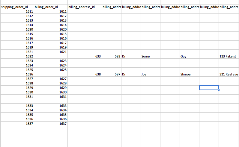

I was trying to export a cvs containing all order details for every order. Everything seems to work fine except the address information (Country, state, ect) is only exported for about 1 in 10 orders.

It seems that every row exported with an address contains an entry in the "billing_address_id" field while those without an address do not. Orders exported with an address are also missing an entry in "billing_order_id" (see attached image names changed for privacy).
When I export using maximum error reporting these errors appear at the top of the csv file

11 years 11 months ago #166668
Thank you for the additional information. That was helpful.
Please replace the file administrator/components/com_hikashop/classes/massaction.php with the one in the archive enclosed and that should fix the problem.
