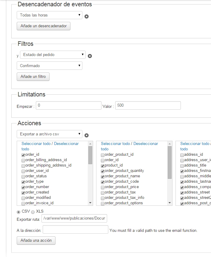

Hello, I'm trying set up a periodical mass action.
I read in documentation and in some Hikashop Forum topics, that "every hour" trigger was activated when mass action is saved.
Well. I create a Mass action with theese options(trigger.jpg):
Published: Yes.
Data: Order.
Trigger: Every Hour
Filter: Order status = Confirmed
Limitations: Start=0; Value = 500
Actions: Export CSV file.
In other Hikashop forum I saw how to rename exported files adding date and hour to filename. I aply it in order not to overwrite exported files.
When I click on "Process" button 2 times, it works properly and generate de 2 diferent CSV files at correct path with apropiate names.
Then I saved the mass action, and wait 2 hours. I expect 2 diferent files, but nothing happend. No files was saved.
Do I need anything else in order to launch trigger?
Thanks in advance.

You need a configured and working cron task:

Thanks. I configured my cron task and wait for results...

Hello again.
When I configure cron task, URL automatically use https protocol.
My question is: Is it necesary use https protocol?. Because, if I configure cron task in this manner, it doesn't work, but if I use http protocol instead, it works without any problem.

No you can use the http one.
