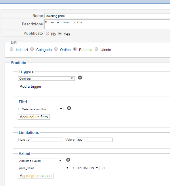

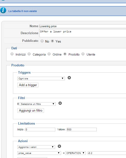

Hello
I was running an hourly mass action on price_value
the price of all products (3 products)was getting lower by a fixed amount
After having done the update from 2.5 to 2.6.0 the action stopped working
information message is attached
It seems tab 0 was missed
Pease how can solve this issue ?
Best regards GG

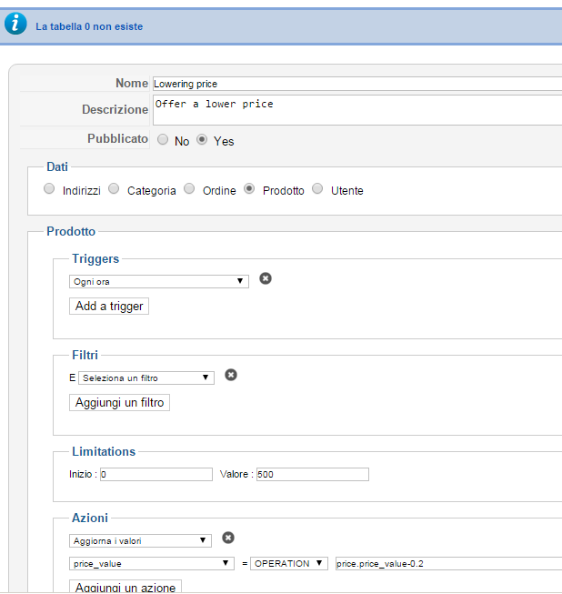

10 years 11 months ago #218581
by Xavier
Replied by Xavier on topic mass action stopped working
Please try to use that string: "price.price_value-0.2" instead of "-0.2".

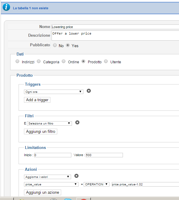

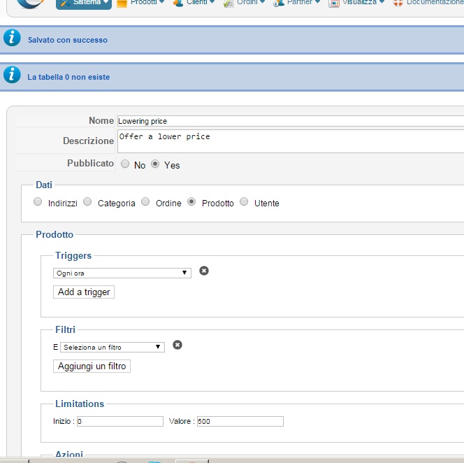

10 years 11 months ago #218667
by 1448giorgio
Replied by 1448giorgio on topic mass action stopped working
Anyway I have got a message from a friend of mine and it may be useful for other user :
belew is the message :
The updated hikashop does not use point "." as the decimal separator.
So when you set "0.2" then it confuses it with a different thing (point is used for classes and tables).
The strange thing is it that the comma also does not functioning as the decimal separator
(tried "-0,2") so at the end i set up it as "-1/5" as 1/5=0.2 and it works. I think somewhere in the settings the decimal separator is misconfigured, but right now i don't have enough time to check it.
It may be that more investigation could fix the issue if any
Best regards GG
