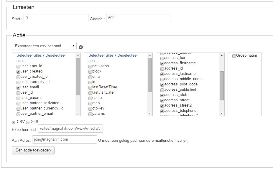

Using the Mass Actions function does not seem to work anymore after 2.6.0 upgrade.
Creating a new action rule did not resolve the problem
What could be the problem?

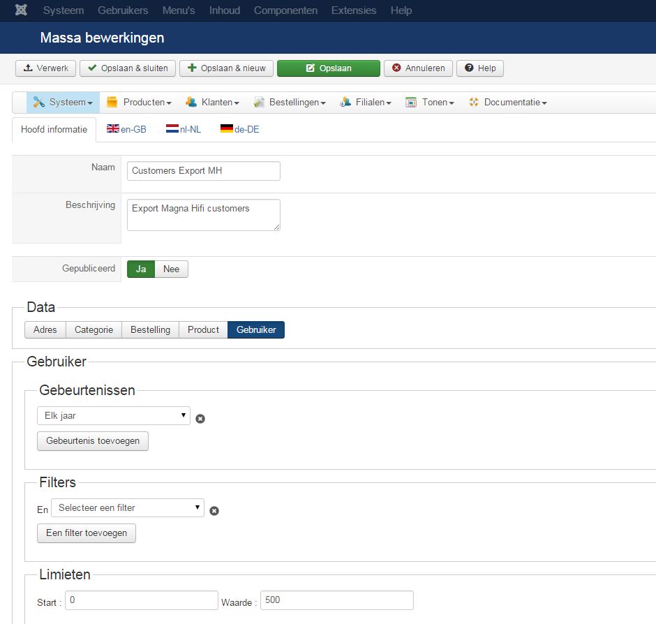

It works fine on our end.
How did you configure your mass action (please provide a screenshot of its settings) and what are you trying to do with it ?

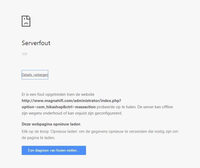

  • Posts: 28
10 years 10 months ago #219139
Strange indeed. We run this export every month. I end up with an error message: Server error 500 (Not 900)
I have no clue, no changes in the export configurations were done.
Thank you for your help
10 years 10 months ago #219140
I think that the issue come from the double "/" present in the url of the path of your file. If not, so:
Do you have this error if you click on the "Verwerk" button ?
If you reduce the quantity of elements to be treated in the "Waarde" field, do you still have an error ?
  • Posts: 28
10 years 10 months ago #219227
I have tried to change the path but same problem.
It worked before, the other 3 exports I have configured used same path, they do not function anymore either.
