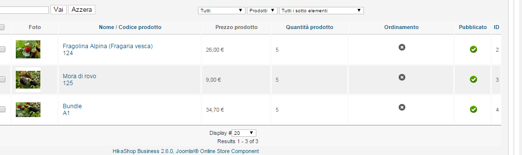

I do not need more than one category and for this reason I have my all ( 3 ) products ..... in product category
1) to filter the single product I have assumed to refers to id number .... in my case 2-3-4
the question is : which is the difference between the use of filtering the product by.... price_id or price_product_id
I ask you this question because mass action does not work properly and I am looking for the correct way to filter the products.......
2) Is cron set every 15 set up correct ?
I am not sure that the mass actions works correctly ..... 2 mass actions triggering every hour the price_value that is lowered by a fixed -0.1 ...... more I set up 3 mass actions triggering (every day) which reset the quantities and prices of the 3 products to a fixed value

I have 3 mass actions triggered every day ... each is triggered on 3 different products
2 of 3 are triggered perfectly every day while 1 of 3 does not work at all (for getting it to work I have to run the process manually ... and in this way all is ok)
