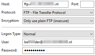

10 years 9 months ago #221535
No still not able to connect, here are my FileZilla settings:

  • Posts: 79
10 years 9 months ago #221626
that looks good, so, it must be the password.
Either you missed my last contactform or you typed the password wrong.
