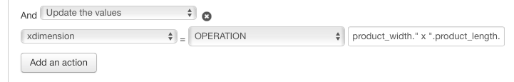

I want to store all core size field sunder a single custom field so I get something like this:
product_width x product_length x product_height
So I tried this setup
product_width+" x "+product_length+" x "+product_height
and the same with ' x ' instead of " x "
also used . instead of +
but the system is TOO SMART and tends to add the values instead of building a text string.
So, how can I join fields to show like its values separated by a constant string like " x "?

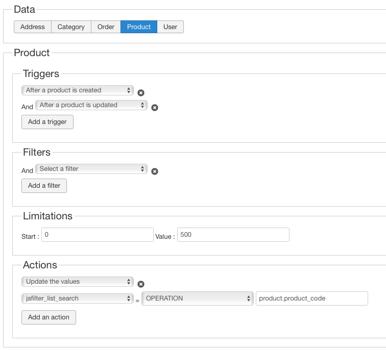

Wanted to reborn this topic on the hope there was some improvement after such a long time.
I want to join several values in a "Update the values" action set with OPERATION mode.
first and simple I want to join
product.product_code + " " + product.product_name
these are both from same table.
then would be great if I could add the Brand name stored in the Category Table
product.product_code + " " + product.product_name + " " + category.category_name (for brand)
I guess the brand thing would be not possible, but for the other part should be possible at this time to join.
I already know how to do this with a triggered plugin but to do with mass actions has become a major need.
