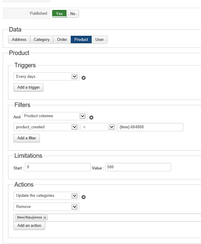

I have mass action where products are removed after 1 week. For some reason products are not removed even I process it manually.
Here is the screenshot of my settings.
Not sure if it is related but I tried to increase value to 5000 and received error:

In you mass action settings it is better to limit to 500 products per request. Else it will consume too much resources.
That should solve your issue.

Well, I have installed your plugin but it made no difference. Mass action still doesn't work.
That configuration was set for about 3 months and I had no issues. Only last week I noticed that I have more then half products in category new. Products created more then 1 month ago are still there....
Tried today again to process it manually but still no products removed from that category.
I also have tried to create new mass action and no luck...
What could be the problem and how can I solve this issue?
I use configurations attached in my first post.
