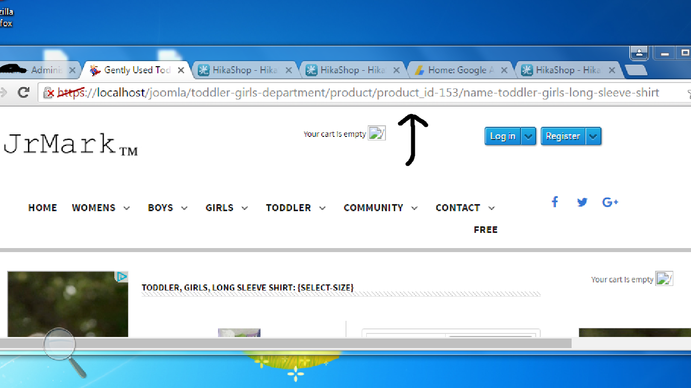

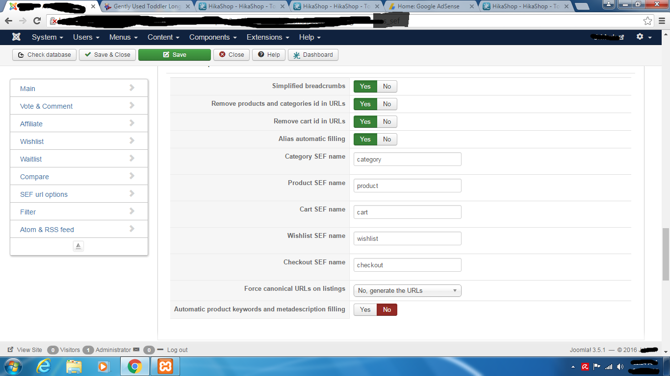

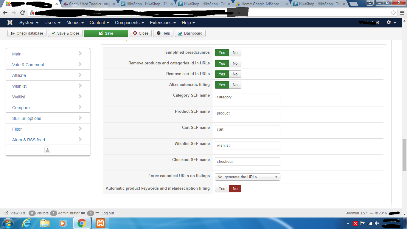

Hello
I have sh404sef enabled
I attached pictures of my configuration
i used mass action [update the values] [product_canonical] and [update the values] [category_canonical]
Then i used [update the values] [ product_url]
Then i used [update the values] [product_alies]
Im stuck im still getting product id in URl
Is this something that i have to take up with Sh404sef?
Best regards

10 years 2 months ago #243352
It must yes. It's either SH404SEF's cache of the SEF URLs, or that SH404SEF is configured to not use the HikaShop Joomla router.
So please check these.
