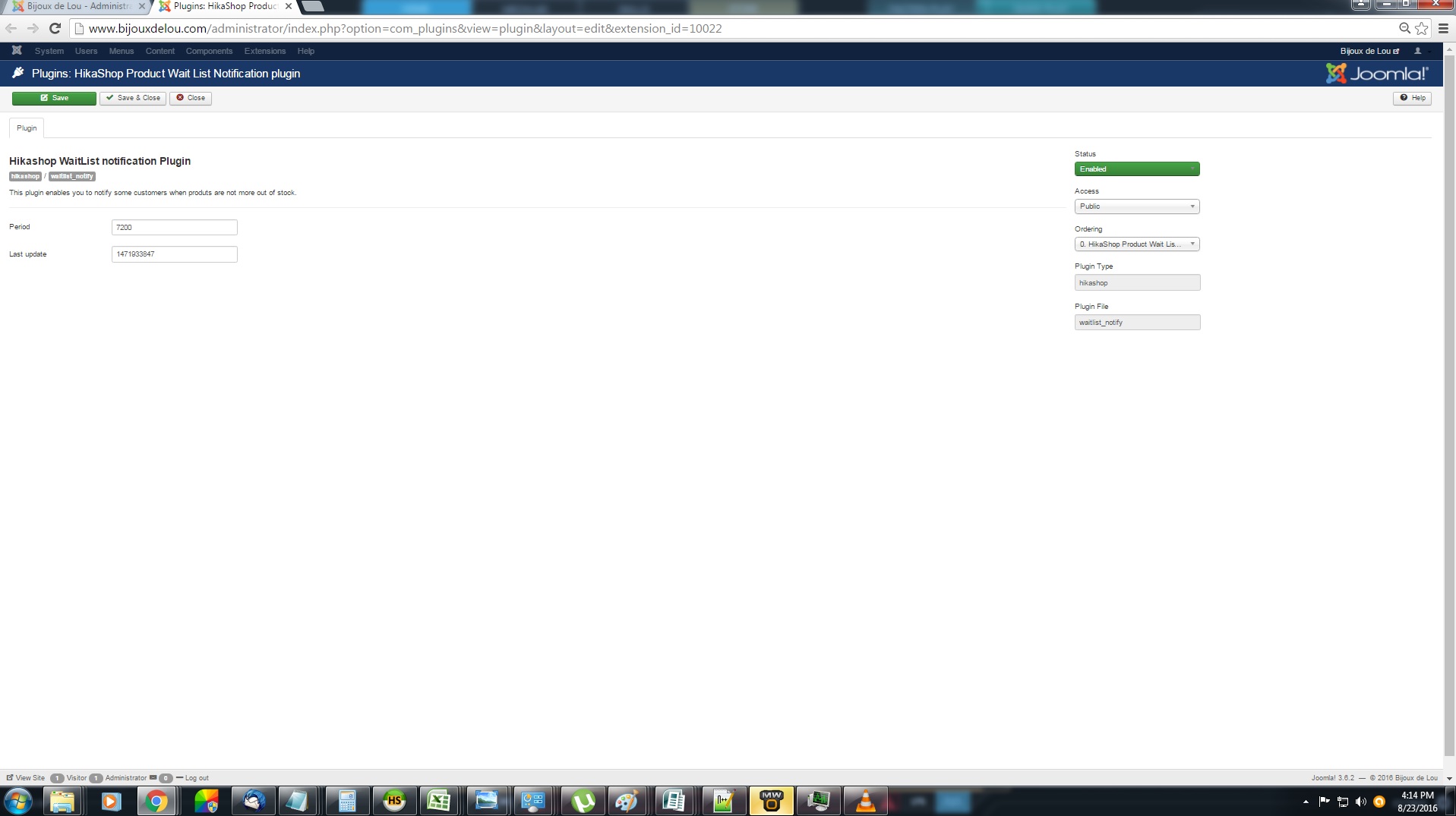

The product waitlist notification plugin is enabled. It appears to be triggering since the last update is current (see hikashop_waitlist_notify_enabled.jpg).

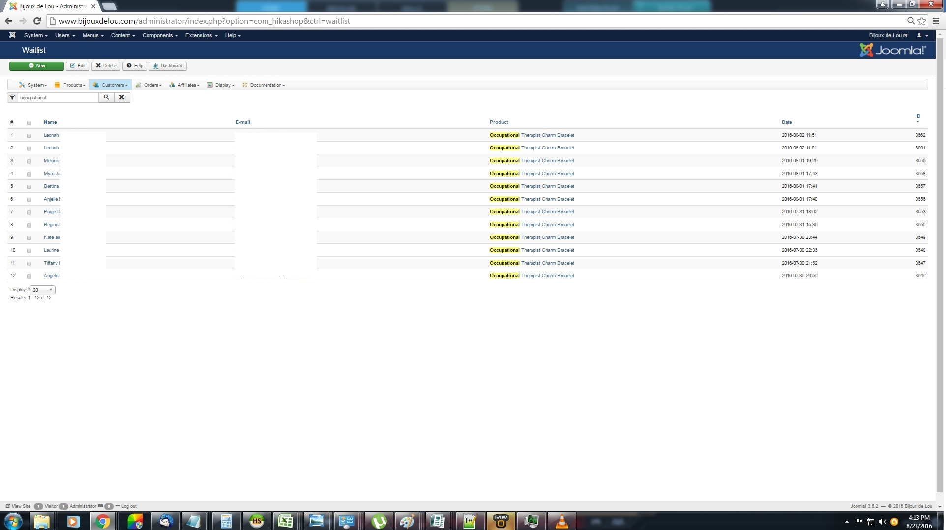

There are waitlist entries for the Occupational Therapist Charm bracelet between July 30 to August 2 (see waitlist_redacted.jpg)

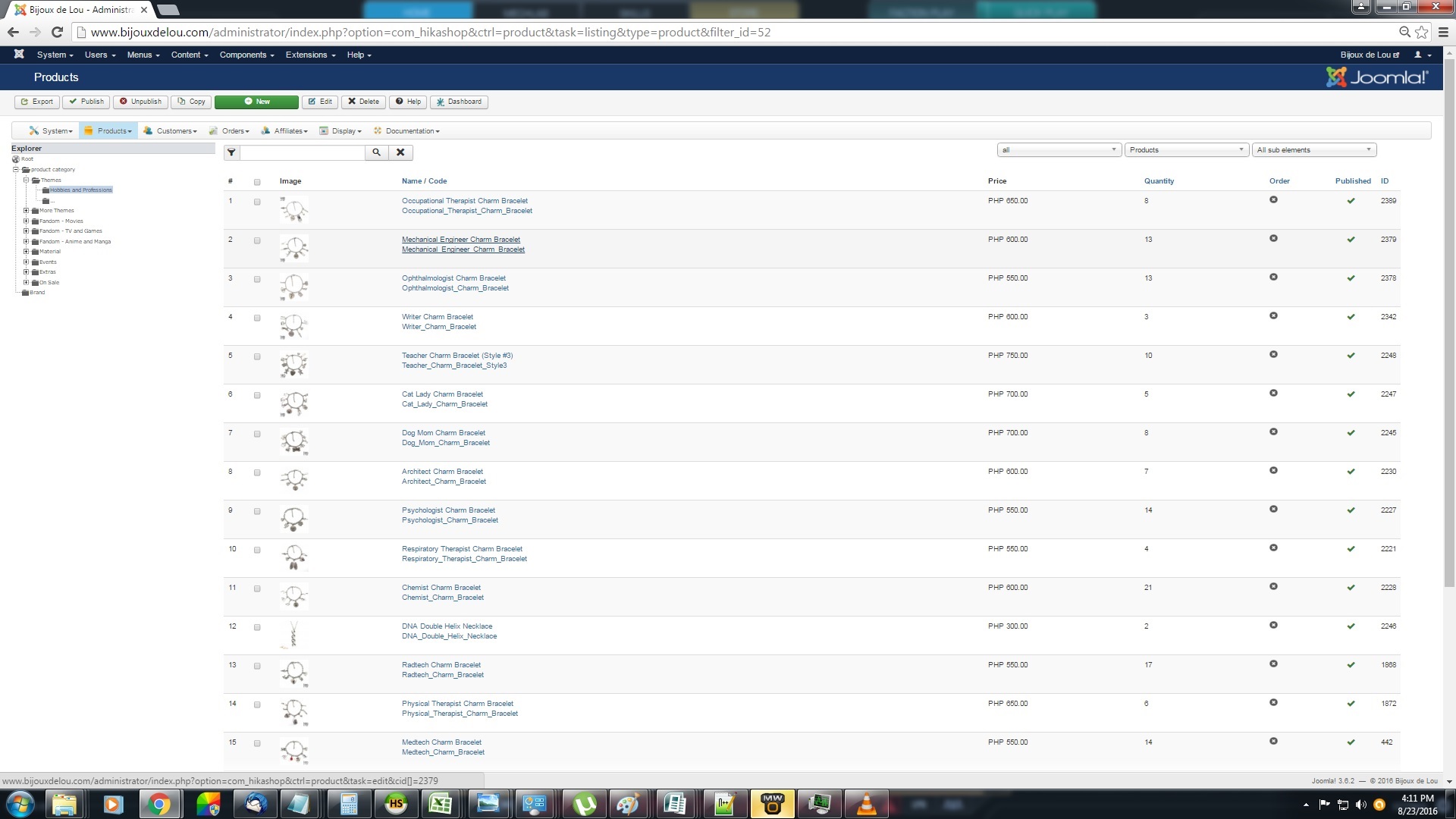

The product "Occupational Therapist Charm Bracelet" (ID=2389) has 8 pieces available (see product_list.jpg).

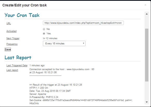

The cron job is running. (see cron_1.jpg)
However, no notification emails are being sent out. Looking at the log (see cron_logfile.txct), waitlist notify last ran successfully on August 1, 2016 and has not run since although there are waitlist entries and there are available stocks for some waitlist entries.

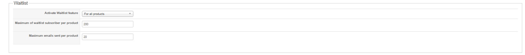

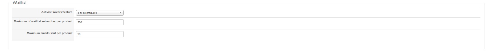

What are your settings for the "waitlist" in the HikaShop configuration ? (tab "features").

Hi Jerome,
Here is a screenshot of the waitlist settings.
Thanks.
  • Posts: 85995
  • Thank you received: 14163
9 years 11 months ago #248322
It looks fine as far as I can see.

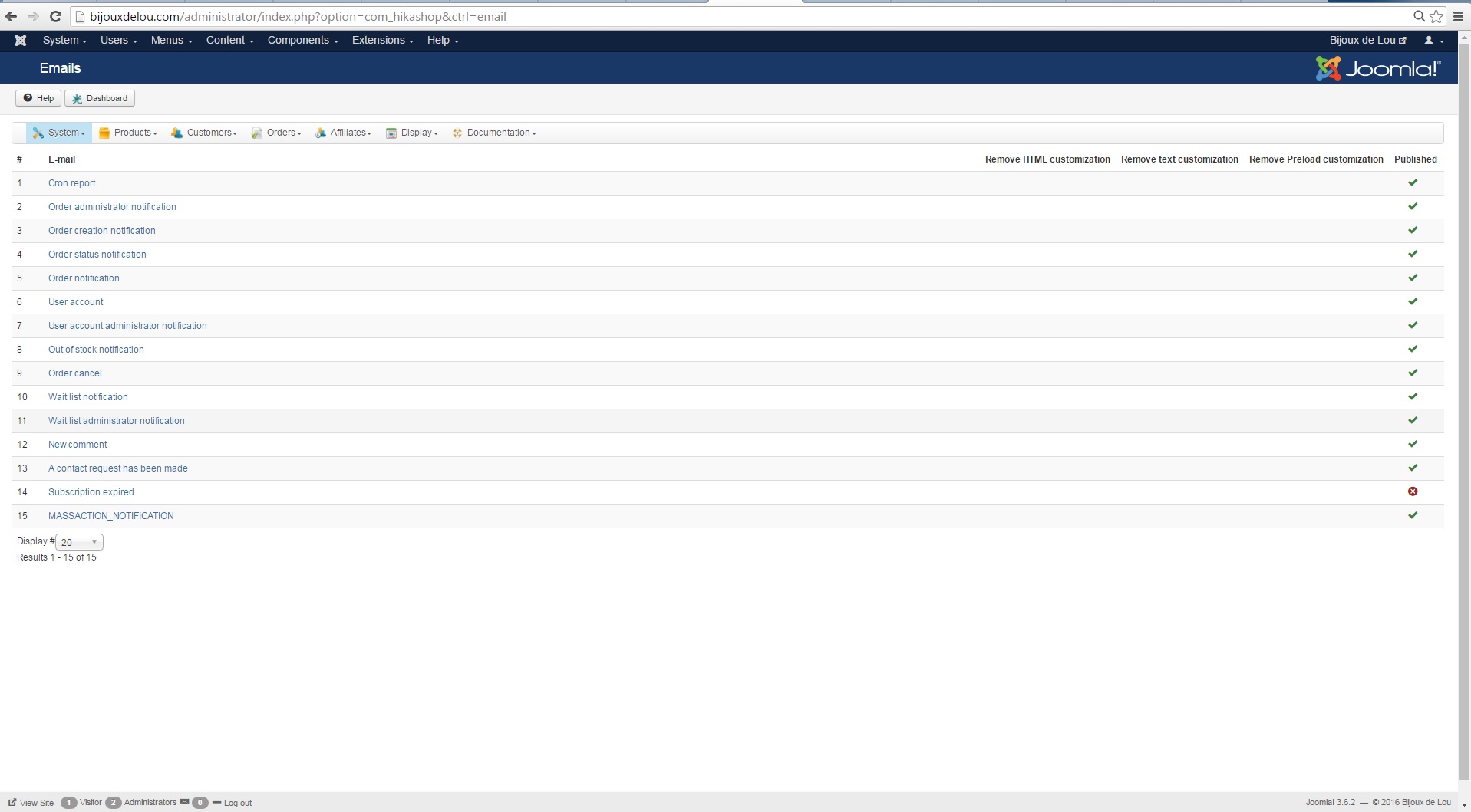

Did you customize the waitlist email via the menu System>Emails. Because that could explain the problem if there was a coding error that mail.

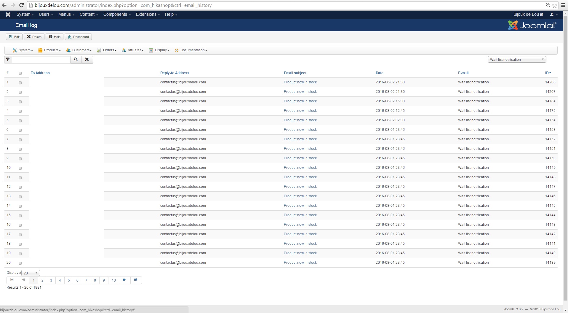

Do you see the waitlist emails in the menu Customers>Email history ?

There are no email customizations (see system_email_customization.jpg).
Last notify email as seen from email history was sent on August 2 at 9:30pm (see waitlist_notify_notification_list.jpg).
