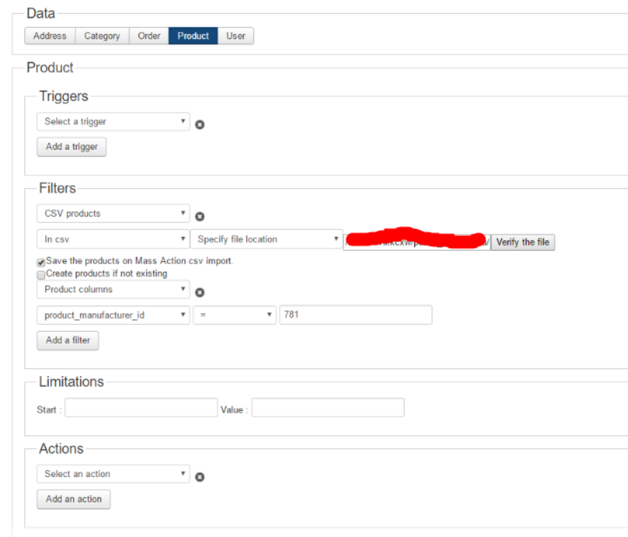

I have many products with different brands
Brand A
Brand B
Brand C
My stock CSV update file contains "only" product_code, and product_quantity.
It contains product_codes within both Brand A, Brand B and Brand C
I only want to uppdate the quanity for the products with Brand A.
Brand A have manufacture_id: 781
Therefore I havel selected under filters: product_manufacture_id = 781
Se image below
So when I process the Mass action it still updates the quanity of the products within Brand B and Brand C.(actually every product_code in the csv file)
How can I force mass action to only update the product_code from the CSV file that goes within manufacture_id: 781) ?
Hope my explenation makes sense.

  • Posts: 86180
9 years 10 months ago #254143
There is no option to do that.
The CSV filter get the products data from the CSV, saves it in the database, and them returns the elements so that they can be filtered further down if necessary so that the actions of your mass action apply only to them.
What you want to do is not supported.
