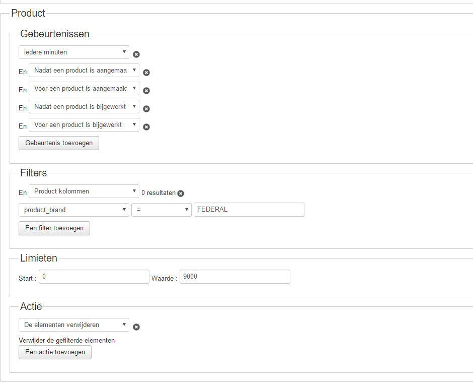

Every minutes i have a CSV syncing products in my hikashop, works perfectly, but i have some products in the CSV which i want to delete.
The CSV hasnt got the right field names so i cant use the filter option in massaction.
So i used the options ( see printscreen added ).
But i still see the products getting back into the shop.
What can i do to delete these automaticly and correct??

  • Posts: 86179
  • Thank you received: 14216
9 years 6 months ago #264081
First, please understand that we speak English. So when you do screenshots it's better to take them while being logged in English so that we can read them and be sure about what we read.

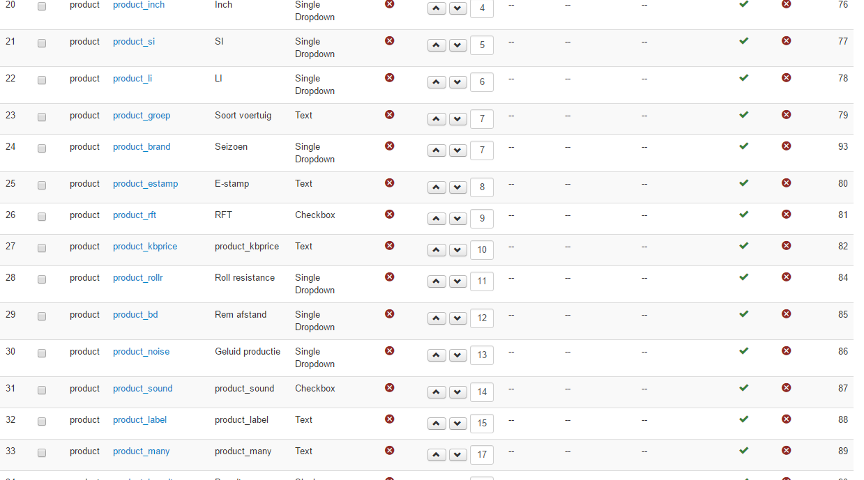

Also, there is no "product_brand" field by default in HikaShop. So I suppose that you must have added that column is some way.
Could you provide more information on that ?
Also, how do you import the products ? What is the structure of the CSV ? Do you have a "product_brand" column in it ?

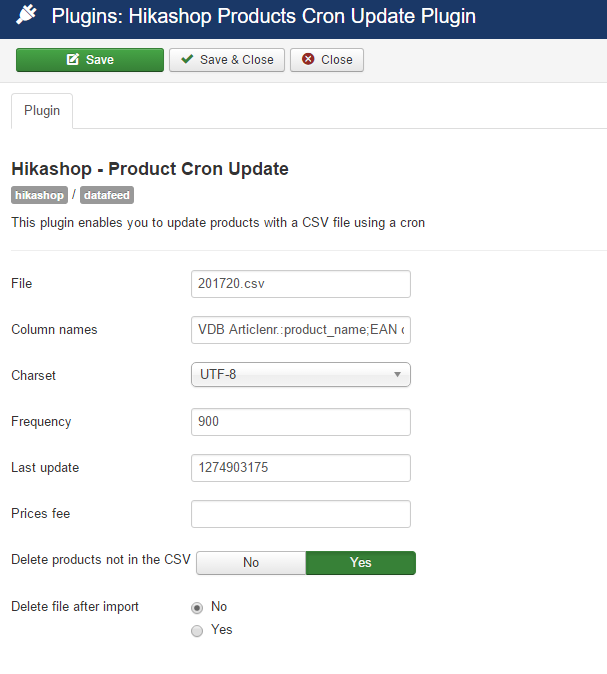

  • Posts: 30
9 years 6 months ago #264178
Sorry indeed, i have changed it back to english.
The product_brand field is a custom field ( see attachement - custom fields.png ) in the product table.
The structure of the CSV is changed to fields the system recognize through the cron job plugin ( cron job plugin attachment with txt )
It is a CSV file of +/- 8000 fields, these are added first manually per 250 products a piece because it wont sync the whole file with cron jobs.
The advice was to manually add them in steps, and then the cronjob wil automatically update the rest ( which it doesnt do ).

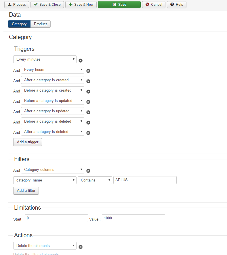

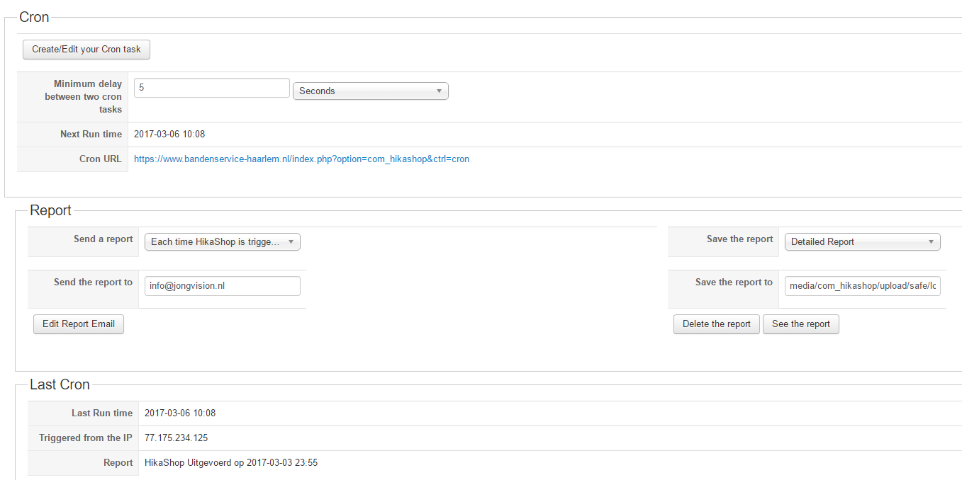

  • Posts: 30
9 years 6 months ago #264226
1. Yes but i did that so that in the first place all the products are inserted, else it would take a while.
2. it triggers indeed, i made a change to the massaction ( see printscreen ) that it would email me when its executed.
It does so, but very sporadic. as i can see this morning it has executed the remove brand 1 : 4 times, and remove brand 2 just 1.
But the cron job does it intervals at 15 min ?? What i have noticed is that sometimes the cron url gives me a 500 error..
3. what i can see now is that he adds the quantity field with the number it has in the CSV and the number in the products database??
so double quantities.. That for the whole 8000 products.
  • Posts: 86179
9 years 6 months ago #264230
2. If there is a crash during the process of something when the cron is triggered, then you won't get notified and the process will stop in the middle. For example, suppose that you have 3 mass actions configured to trigger every minute, and you have a cron configured to trigger every 15 minutes. So the cron will trigger the mass actions every 15 minutes and each mass action will run each time as their frequency is lower. However, if you have an error popping in the first one, then it will stop the process and the two others won't be executed.
If you want to run your mass actions more often, you would have to configure your own cron as the one we provide has a minimum frequency of 15 minutes:
www.hikashop.com/support/documentation/5...ron-task.html#server
3. Supposing that you use the standard HikaShop product cron update plugin, there is no option to activated that, but if you have a parameter update_product_quantity in the URL of your cron task, it's possible that the quantity is added instead of replaced.
That's done by the code:
if(JRequest::getInt('update_product_quantity','0') && $field=='product_quantity' && $product->product_quantity != -1){
								$product->product_quantity += $already[$product->product_id]->$field;
in the file administrator/components/com_hikashop/helpers/import.php
