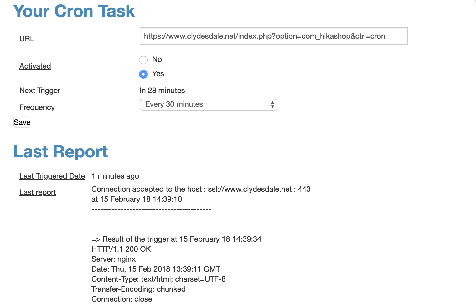

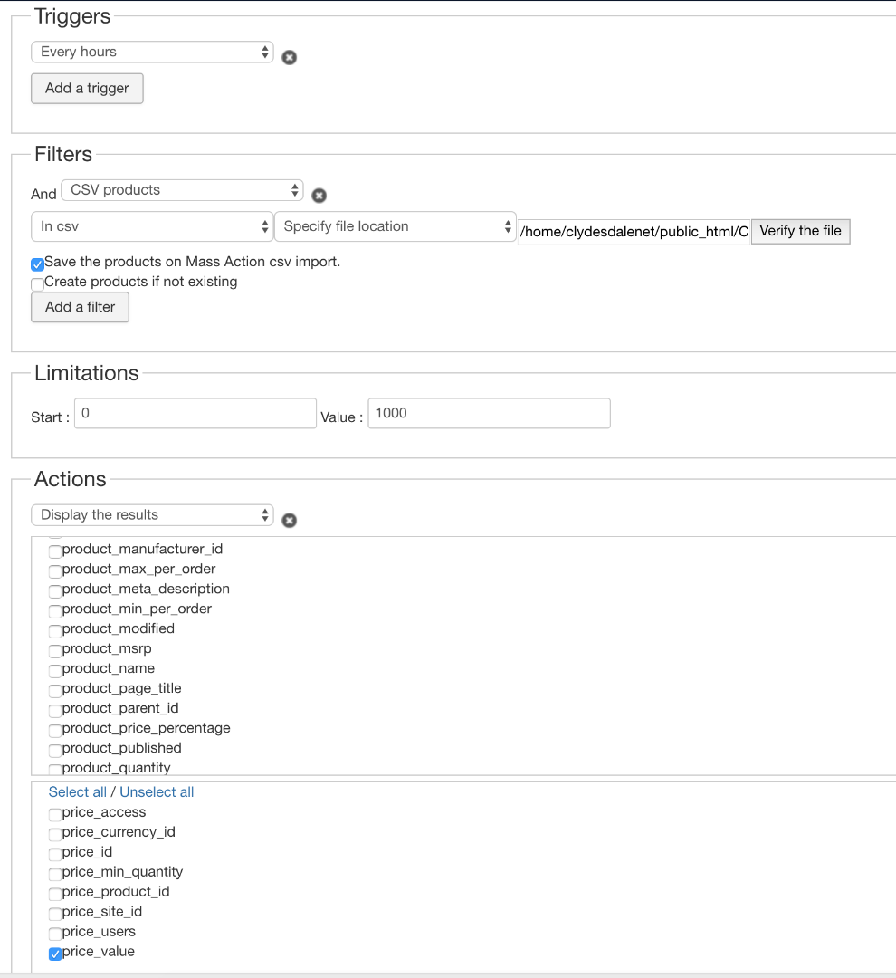

I have a mass action setup to update only price_value from a CSV. Which works and functions fine when you manually process the mass action.
I also have a cron job setup which triggers every 30min.
But with both of these processes working the data doesn't seem to automatically update. I have attached the screen shots of both.
I have noticed a 'Hikashop Cron Plugin'. Does that need to be enabled and configured too?
  • Posts: 256
8 years 6 months ago #287981
Hello, I am sorry it does seem to be working and updating automatically.
However the settings I have used only seems to replace prices that already exist, what settings would I use to add prices onto a product which didn't have any price before?
  • Posts: 86112
  • Thank you received: 14210
8 years 6 months ago #287987
In that case, you should look at using the HikaShop product cron update plugin instead of the mass action system.
The CSV import of mass actions is a simple one and it can't create prices. The one in the plugin is the same as the one in Products>Import and thus can handle a lot more things.
