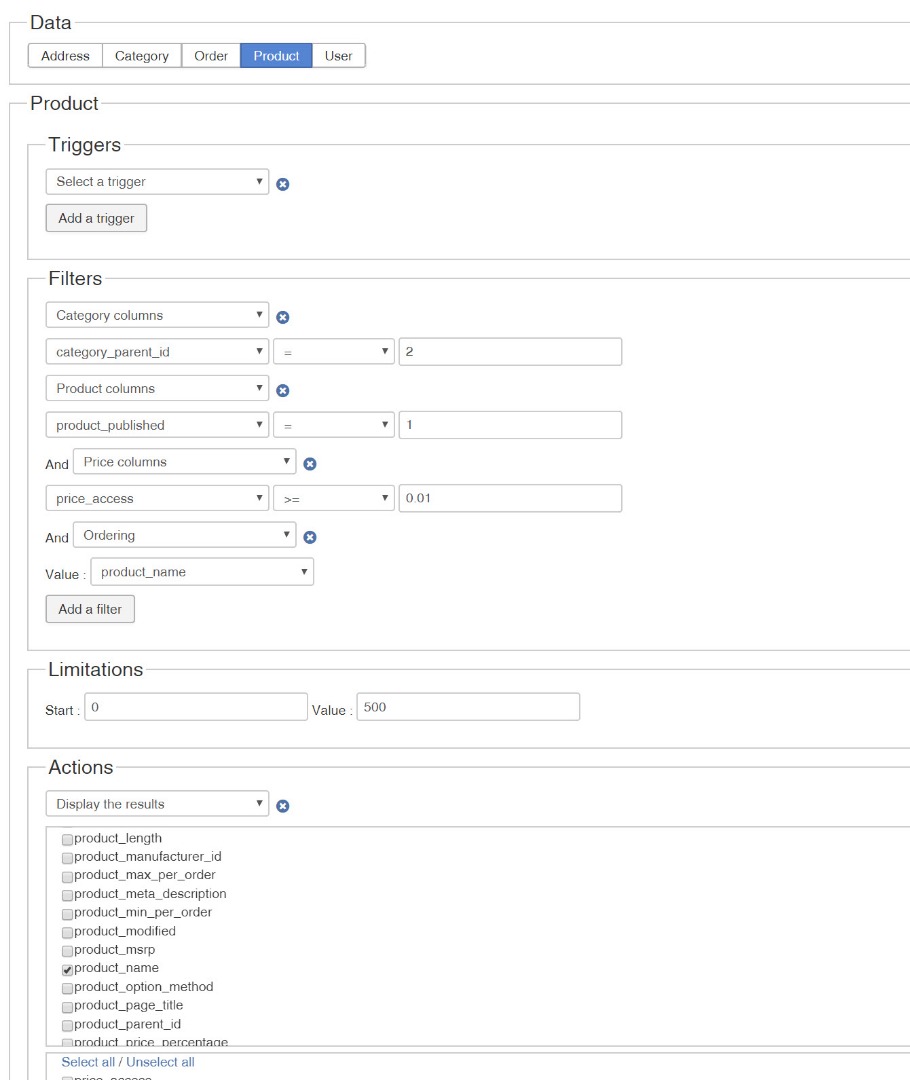

There is a BUG in het Massaction in combination with PHP 7.1 or 7.2
This bug was already there in versionn 3.5.1

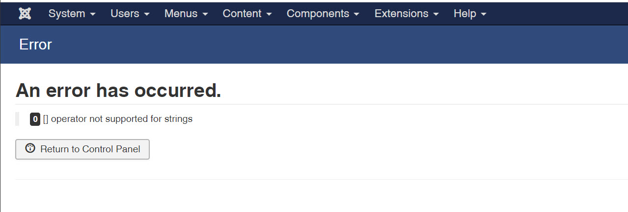

When you create this action (especially with the ordering function) then you get an error.
The error is:
Hope you can fix this issue.

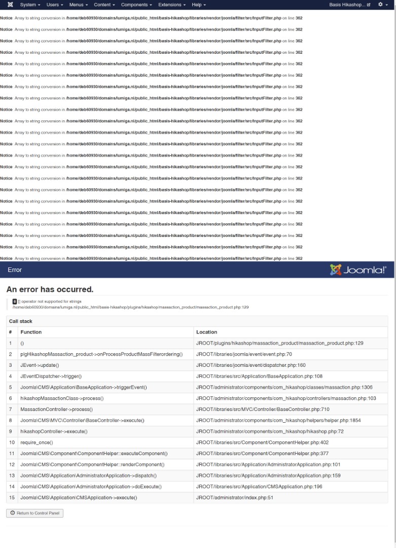

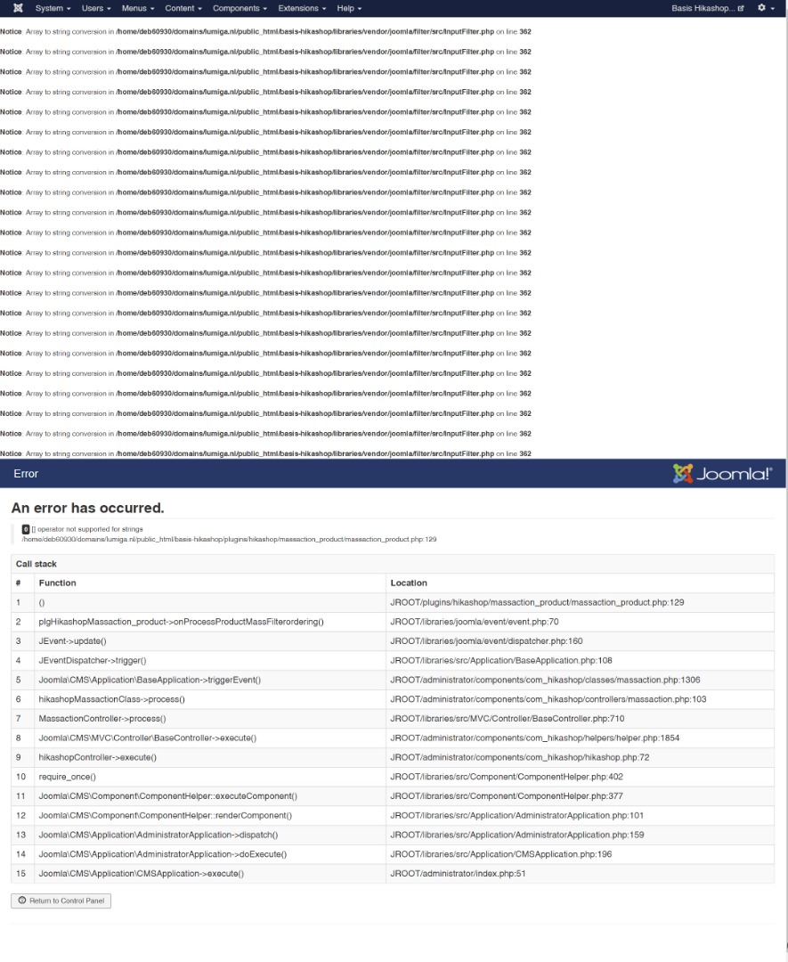

Can you please activate the "error reporting" and "debug mode" settings of the Joomla configuration and try again ? That will give you an error with much more information so that we can better understand what is the problem.

7 years 10 months ago #300142
Kind regards,
Lumiga

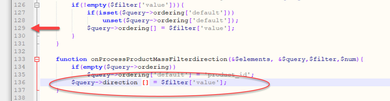

7 years 10 months ago #300241
I changad the line and, but it still did not fixed the issue.
Should not the rule 129 be adjusted?

No, the lin 129 is correct. $query->direction is supposed to be an array.
The problem is that the function is called and that variable is already not an array.
So it means that something else somewhere set it as a string and it shouldn't. I looked around to try to find the cause and this line 136 was definitely not correct so I thought it might be coming from it.
