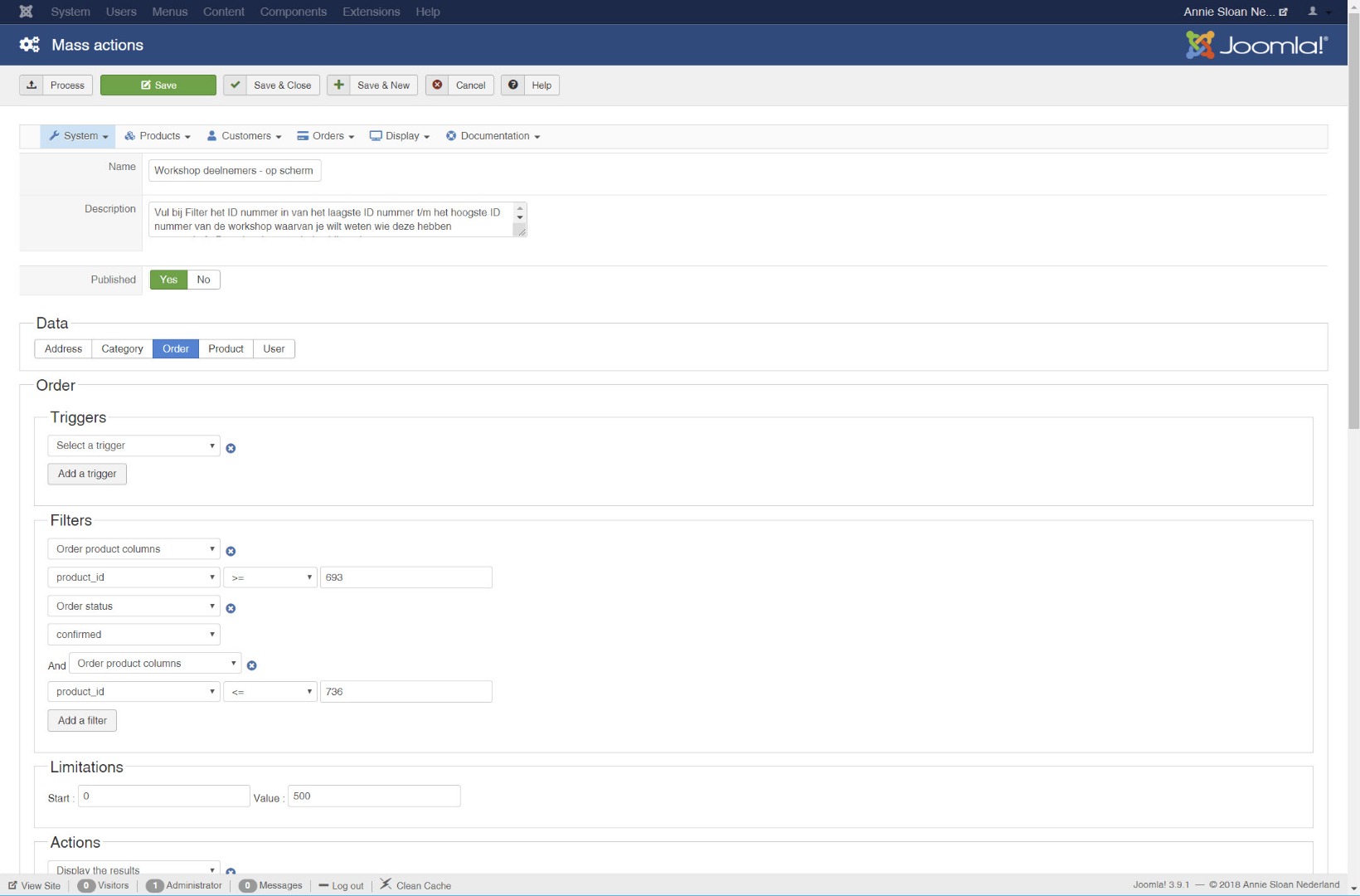

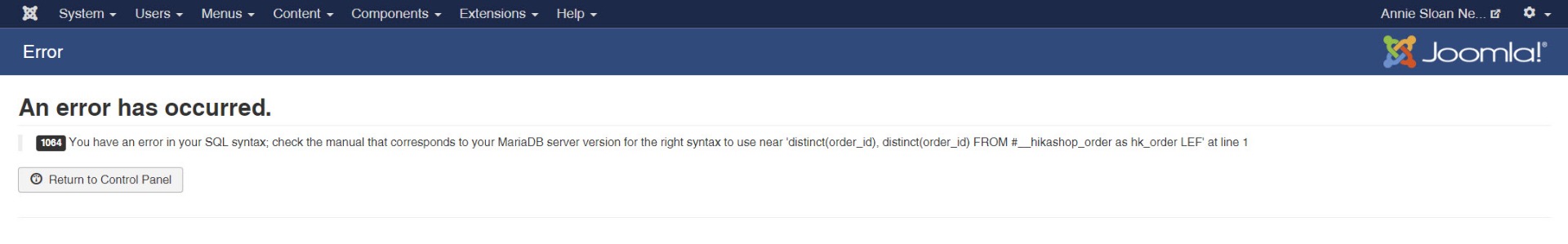

After the update to 4.0 and 4.0.1 we get this error when we use a mass action:
1064 You have an error in your SQL syntax; check the manual that corresponds to your MariaDB server version for the right syntax to use near 'distinct(order_id), distinct(order_id) FROM #__hikashop_order as hk_order LEF' at line 1
Our mass action look like this:
