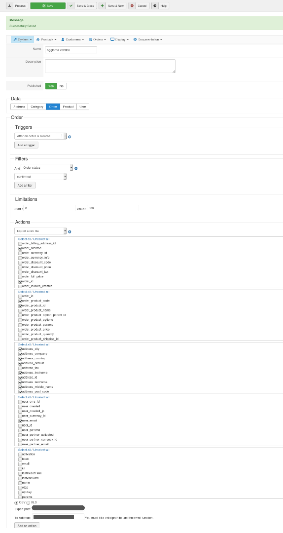

I did use a trigger set to "order created" as you can see in the attached image where I show you all my settings for the action.
Everything works fine if I trigger myself the procedure using the "Process" button.
I expected to find the updated csv file on the server when returning from paypal site after buying the product. But no file is produced.
Maybe is because I have the free version?
thanks for your reply.
