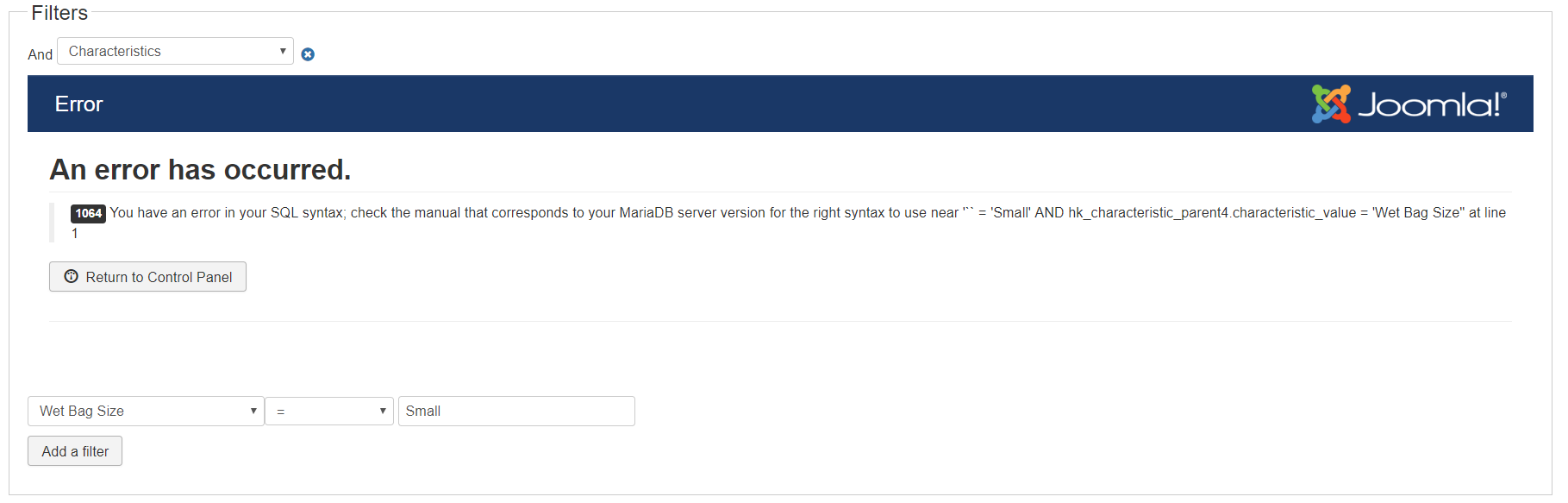

6 years 3 months ago #319877
-- url of the page with the problem -- : seemybag.gr/alpha
-- Joomla version -- : 3.9.18
-- PHP version -- : 7.4
-- Error-message(debug-mod must be tuned on) -- : Error in SQL syntax
when I try to add a filter for a product Characteristic I get an SQL Error.
See attached image for info.
  • Posts: 86114
  • Thank you received: 14210
6 years 3 months ago #319882
Thank you for your feedback. We've added a patch on our end for that. Download again the install package of HikaShop on our website and install it on your website and it will add that patch.
