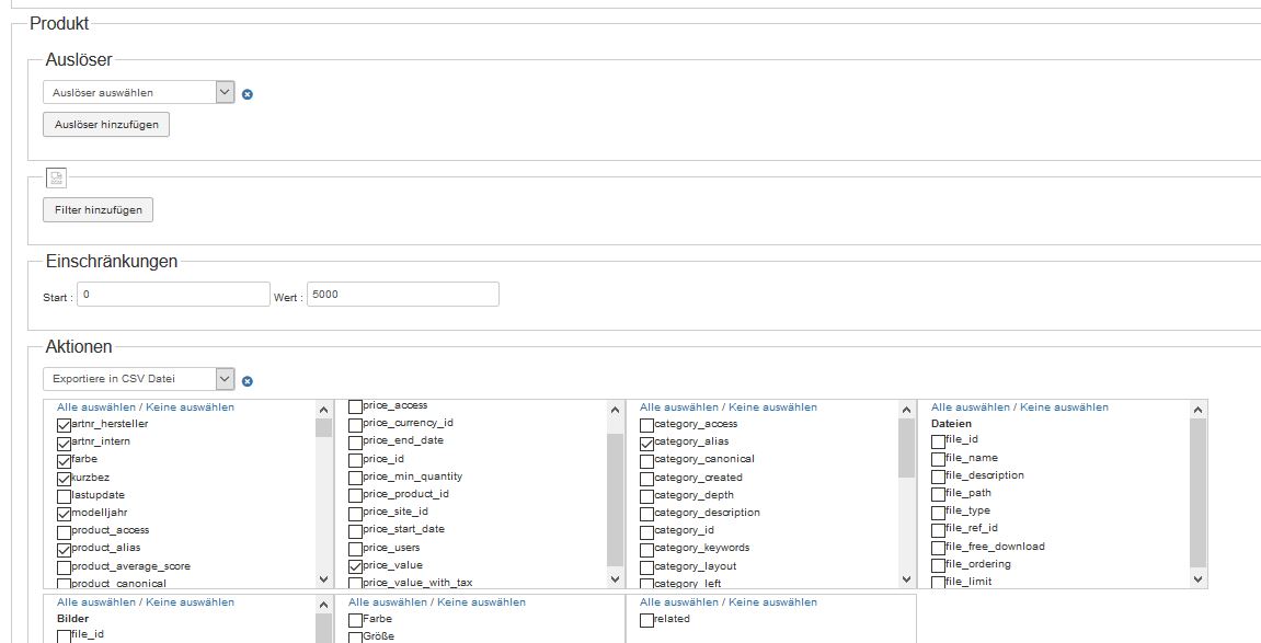

Hi.

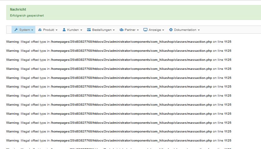

after installing 4.4.1 mass actions CSV exports with relationship are not working anymore. The mass action is creating a dump and was running since years. Now it creates
Warning: Illegal offset type in /homepages/25/d83827768/htdocs/2rs/administrator/components/com_hikashop/classes/massaction.php on line 1125
for every entry and all product fields are missing in the export.
After de-selecting the fields in Prices / Categories the action is running.
thanks
Markus

I got the backend access and I can indeed see the mass action and see the warning when trying to run it.
Unfortunately, that doesn't help me as I already know the warning message.
The problem is that I can't reproduce the issue on my end so I can't add any debug to understand what is going on.
