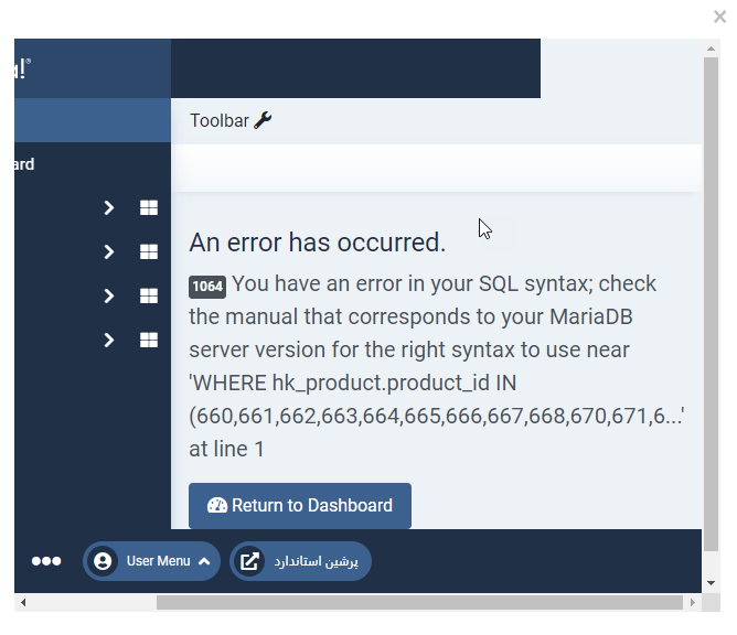

4 years 2 months ago #344357
by khashiz
Replied by khashiz on topic Adding string to description
Hi.
today I tried to use this code.
I put some html instead of "my extra text" and the system returned error.
can't I put html there ?
4 years 2 months ago - 4 years 2 months ago #344358
by khashiz
what I exactly want to do is that if my description's html is :
<p>some text</p>
I want to add :
<div class="class1">some other text</div>
at the end of it.
so the final description would be :
<p>some text</p><div class="class1">some other text</div>
screenshot of the error i get is attached
<p>some text</p>
I want to add :
at the end of it.
Last edit: 4 years 2 months ago by khashiz.
4 years 2 months ago #344359
by nicolas
Replied by nicolas on topic Adding string to description
HTML is stripped for security reasons.
If you want to temporarily disable that, you can remove the line:
$value = strip_tags($value);
from the file administrator/components/com_hikashop/classes/massaction.php
Then, you'll get the HTML in there too when you process the mass action.
