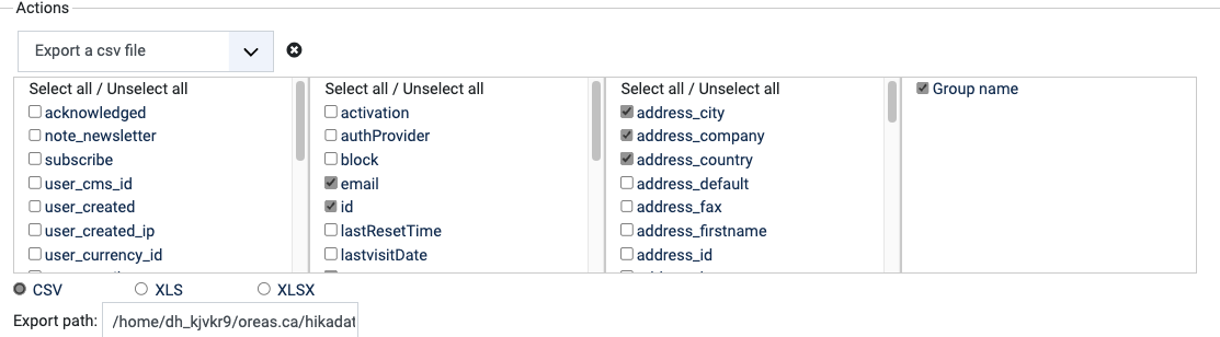

-- Error-message(debug-mod must be tuned on) -- : An error has occurred.
1146 Table 'xxxxx.j3crm_hikashop_usergroups' doesn't exist
In MassActions it is possible to DISPLAY the usergroup information but not when exporting.
*Note* Additionally, in the actions section under "GROUP NAME" no groups are displayed.
