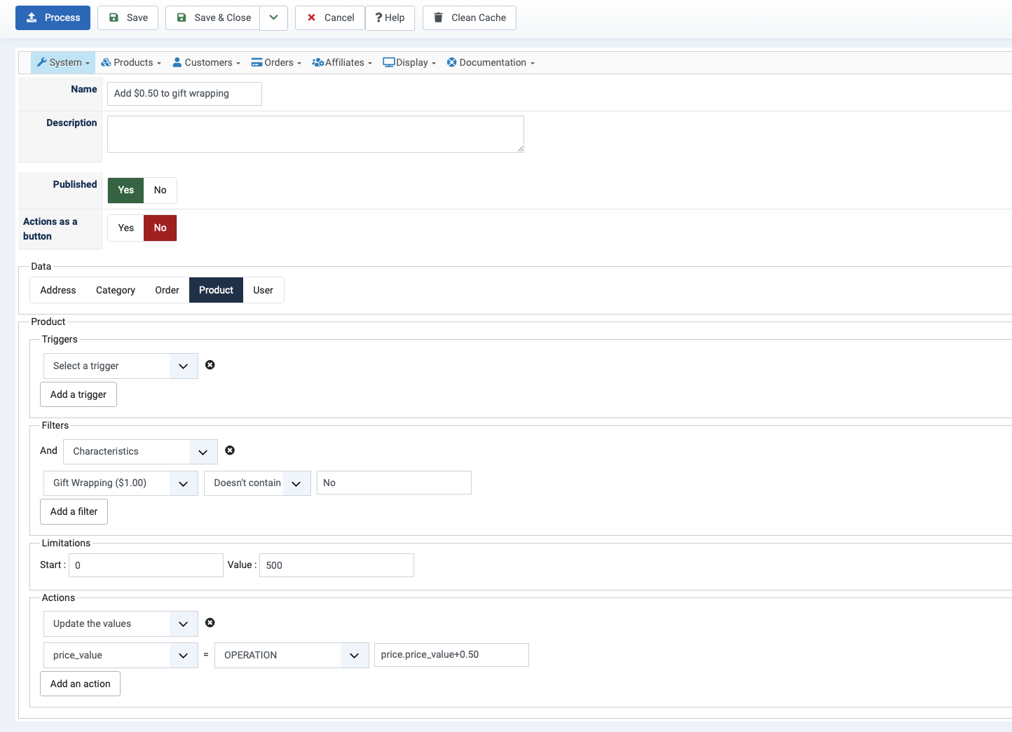

We have a Mass action to update the variant price by $0.50. When we run the action, it triggers a 500 mysql error.
  • Posts: 86077
  • Thank you received: 14186
2 years 10 months ago #355847
Can you provide a screenshot of your massaction settings please ?

2 years 10 months ago #355850
Screenshot attached

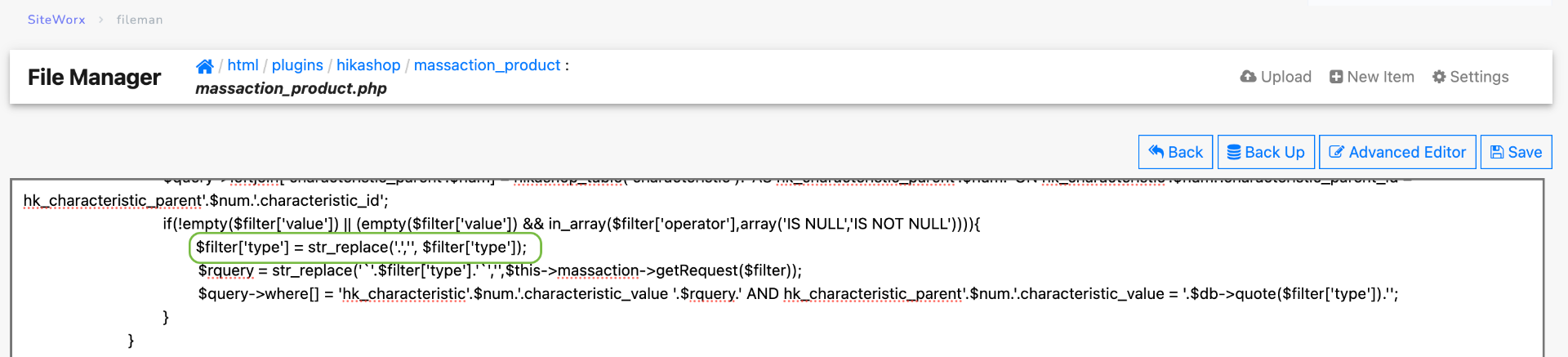

Add the line:
$filter['type'] = str_replace('.','', $filter['type']);
before the line:
$rquery = str_replace('`'.$filter['type'].'`','',$this->massaction->getRequest($filter));
in the file plugins/hikashop/massaction_product/massaction_product.php and it should fix the problem.
Let us know how it goes so that we can include the patch on our end.

2 years 10 months ago #355881
I added the line as requested in the plugin and the Mass action is not throwing an error. However, it still does not seem to be updating the price as needed.
Please advixe.
Brian
