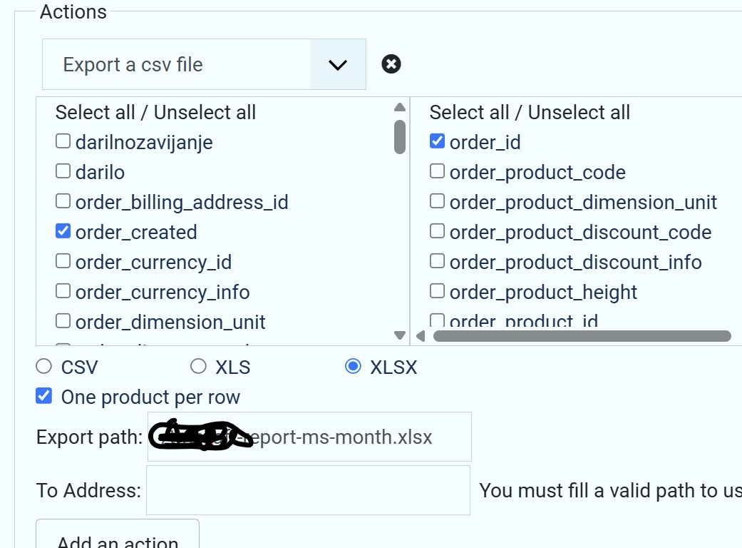

I created new action. Set it without trigger, saved and manually click process. I get Successfully Saved. No file is created.
Then I tried with Display the results. Again I get Successfully Saved but nothing happens.

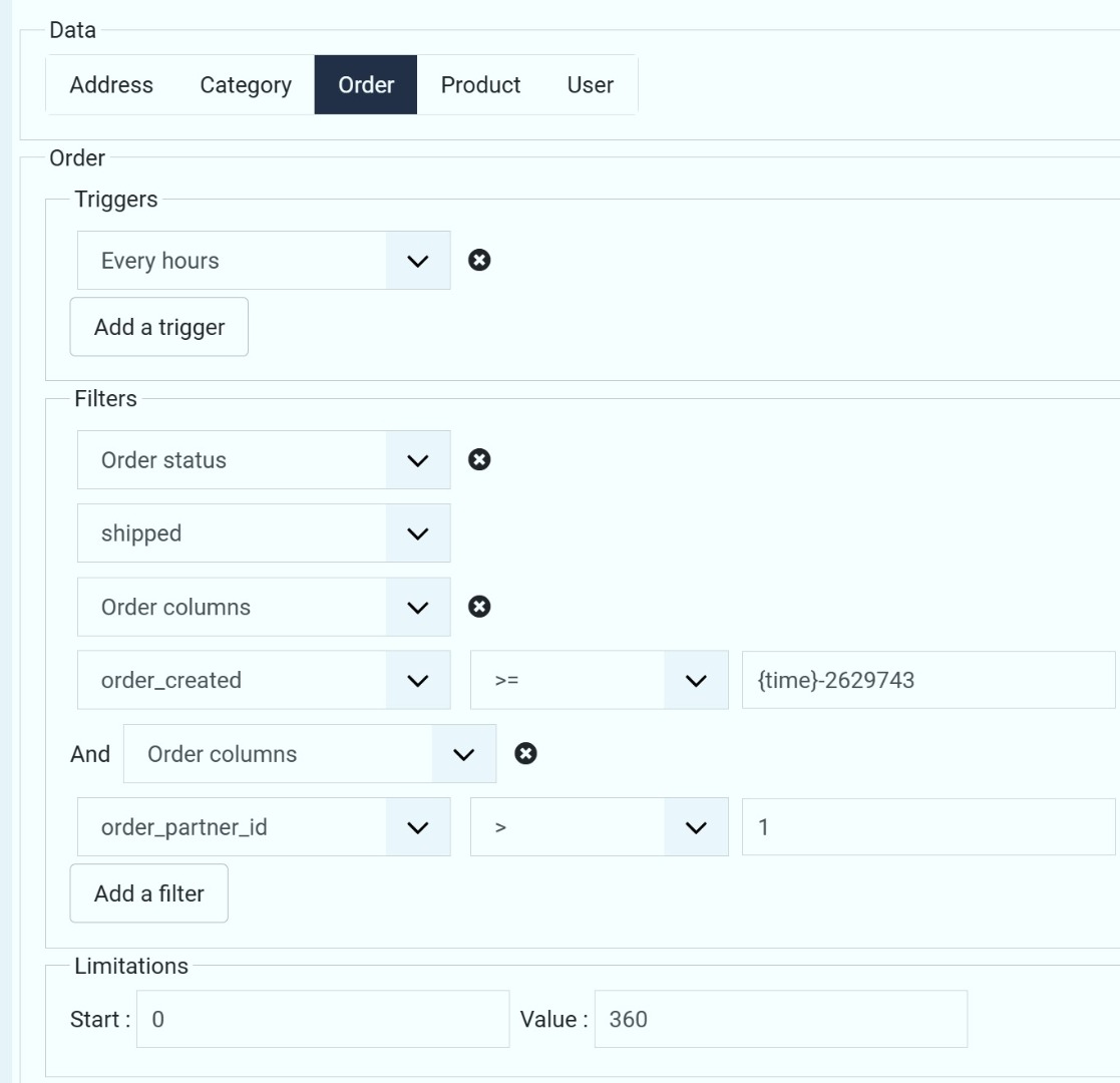

If you look at my first post and filter setup, it should show all orders in last 30 days with affiliate. In my affiliate statistic there are at least 5 sales.
If I remove filter order_partner_id it shows latest orders.
So how to set filter to show affiliate sales from one specific partner and from all partners?
  • Posts: 86214
  • Thank you received: 14221
1 year 5 months ago #366702
That's not what I see. You configured your filters to get only the orders from the last 30 days with a partner different than the partner with the id "1".
If you want to also take into account the partner with the id "1", then you need to change that filter to be either "> 0", or ">= 1".

Partner id is all greater then 1 (22270, ...). So it should show.
  • Posts: 86214
1 year 5 months ago #366722
Well, I don't see another reason.
If you want to target a specific partner, you can have a filter on order_partner_id = xx where xx is the id of the user in HikaShop which is the partner.
And for all the partners, order_partner_id >=1 should do the trick. At least, it works on my end with my tests.
