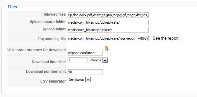

12 years 9 months ago #126617
I do not see "Enable customer download area" see attached screen shot.

12 years 9 months ago #126668
What's your HikaShop version (number) ?
  • Posts: 19
12 years 9 months ago #126691
version is 2.1.3
12 years 9 months ago #126709
Can you download the last Hikashop version through our website, install it, and test it again ?
