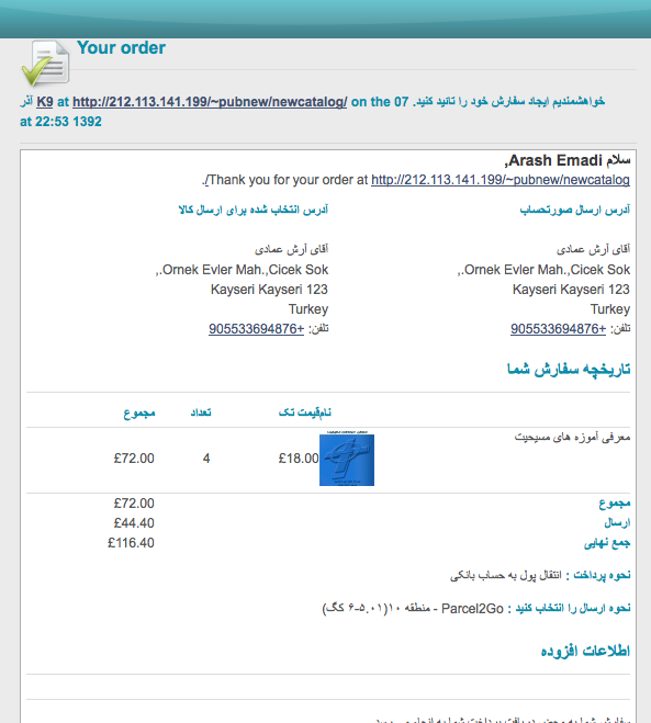

I'm facing a problem which I think is related to some CSS missing or not written correctly. I'm using HIKASHOP in 2 languages (FARSI : RTL and ENGLISH : LTR) this has caused me many problems which I've solved with the help of Nicolas (from the Hikari team). This is the latest thing I've faced. I checked the payment receipt sent to me in English and it's perfectly working.. But in farsi, as you can see in my screenshot, it's corrupted and not showing the way it should. what css code am I missing? can you help me out please? It is very important for me since I'm launching the website tomorrow. and I don't have a clue where to find this code. Thanks in advance.
Some of the problems I need fixed :
1. The texts are not RTL and instead they're LTR. What can I do to make them look good both in English and in Farsi. (I don't want fixing the Farsi to break the English version!)
2. The table in the middle is also set to LTR instead of RTL. What can I do about that?
Thanks for your help! Again since this is very urgent for me, please reply as fast as you can.

Change the line:
'</head><body>'.hikashop_absoluteURL($mail->body).'</body></html>';
to:
'</head><body'.$htmlExtra.'>'.hikashop_absoluteURL($mail->body).'</body></html>';
in the file administrator/components/com_hikashop/classes/mail.php and try again.

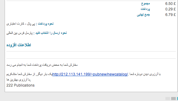

1. the table has some MINOR problems regarding the alignment of the names and the values related to them...

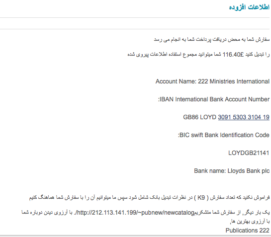

2. Can I have a farsi version of my BANK TRANSFER DETAILS for my Farsi customers? in the 2nd image you can see that since it's now aligned RTL it's not looking correct since it's in English. and I need to have the BANK NAME etc., in Farsi. any suggestions?

1. You need to edit the email via the menu System>Emails and change all the instances of:
float:left
to:
<?php $lang = JFactory::getLanguage(); if($lang->isRTL()){echo 'float:right';}else{echo 'float:left';} ?>
and all the instances of :
text-align:left
to:
<?php $lang = JFactory::getLanguage(); if($lang->isRTL()){echo 'text-align:right';}else{echo 'text-align:left';} ?>
2. in your bank transfer information field, enter a translation key and then add that translation key as a translation override in your language files:
That way you will have a different text for each language.

As I said, the translation key should be put in the "information" field of your bank transfer payment method and then you should add a line to the translation override file of your language (as explained in the documentation link I gave) for the translation key.

Just add it in a new line of the override area of your translation via the Languages tab of the configuration, as explained in the documentation I gave you.
For example:
MY_TRANSLATION_KEY="My text"
The following user(s) said Thank You: PubSite

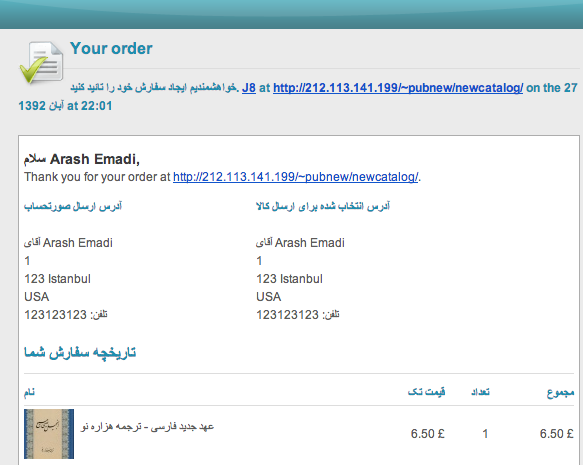

Dear Nicolas.. about part 1.. I still haven't been able to fix the problem as you've suggested. I tried changing the instances as you said and the site didn't come up.. Then I thought, is it even possible to use these PHP tags in CSS?! I'm a little confused and my emails are still looking wrong. to be precise only the NAME of the product is sticking to the price tag next to it. How should I implement this? I have disabled the order creation emails and emails are sent only after payment (order status notification). I thought that might help you if you know.
