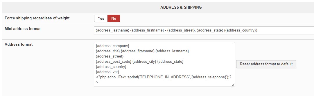

EDIT: I also checked the address format and this is what it looks like.

  • Posts: 86077
  • Thank you received: 14186
5 years 11 months ago #323396
Did you click on the save button of the HikaShop configuration page ?
That will update all the the view overrides and make sure that the format is correct everywhere.

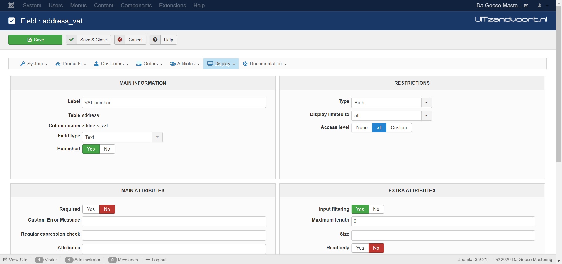

I did, didnt matter. All other options that I made where saved and when I reopen the configuration, the line is there as well.'
Attached is the address_vat in the custom fileds. It works everywhere (inclduing right calculations and evetrything), except for the confirmation emails.:dry:
  • Posts: 86077
5 years 11 months ago #323438
I don't see why it wouldn't work.
Could you provide a backend access and the order number of an order with the issue so that we can check on the situation ?
