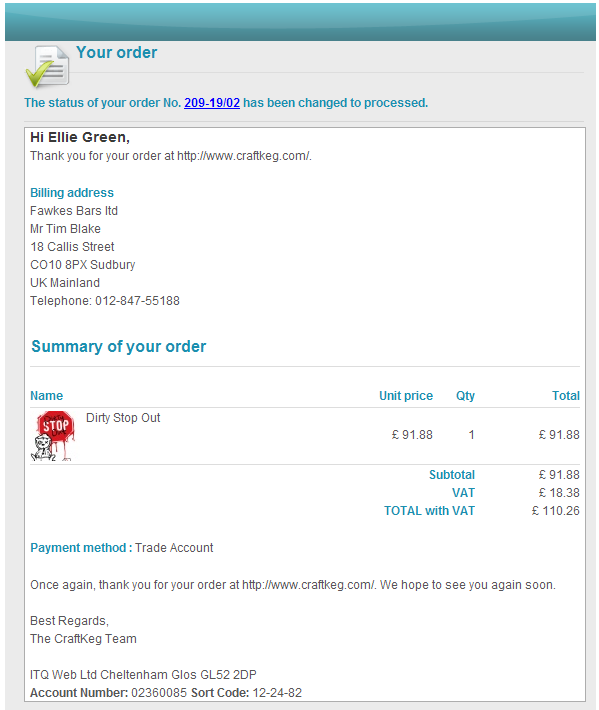

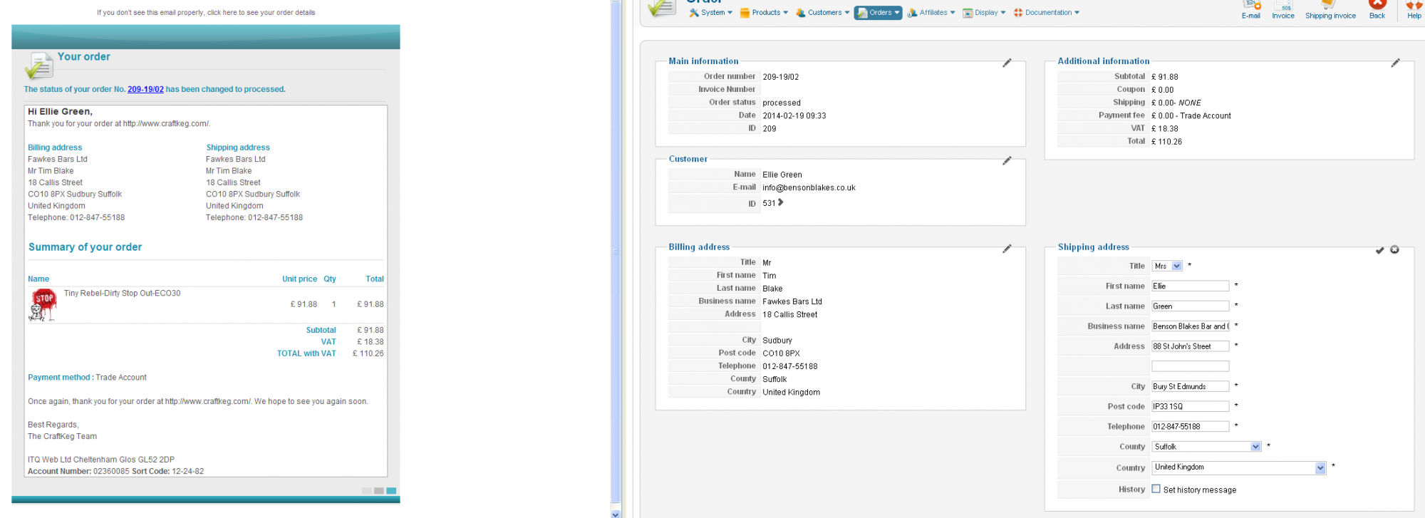

When I'm dealing with an order in the back end, if I try and send out the confirmation email out to a customer again it fills in the Billing and Shipping address as the same, even when the Shipping address is different.
I've attached a print screen of my back end Order page and the email it sends. Should be noted that this only happens in the backend, not if placing an order with different billing and shipping addresses from the front end of the site.

Yes I did have some customization which I have now removed so they are updated to 2.3.0. However, I just tried to email myself the confirmation from the backend screen again and now instead of duplicating the Billing Address, there is no Shipping Address at all!
