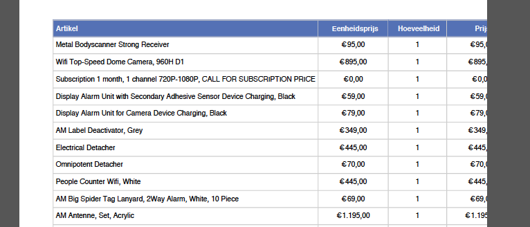

Hi, I'm using the plugin 'PDF invoice'. It works nice in basic, but the problem I have (mainly when selling multiple products) is the width. The tables get too wide causing the information to 'fall off' the page at the right. I see for example not the complete price. I switched back to the original (not modified by me) invoice.php, but there I've got the same problem.

I know it's customizable, but I don't expect from a paid plugin to have these issues. I have looked into the code, but for some strange reason I can't find the problem, tried several options with width. But again, I expect the standard plugin to work without these problems.....

I found a solution. Around line 107 in the original invoice.php there's a line:
<td>
Which I changed to
<td style="width:500px;">
That did the trick...
