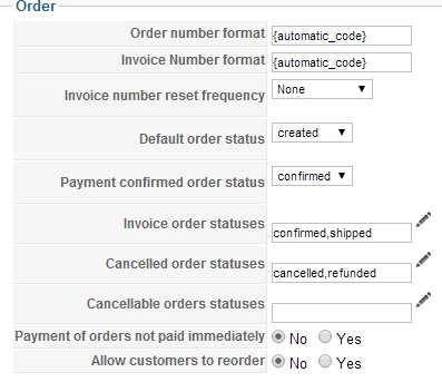

12 years 6 months ago #145965
The customer will gain the points when the order will be confirmed.
The order is confirmed when his status is one of the status of the HikaShop option : Invoice order statuses ("Main" tab, "Order" section).
So you have to change the order status to let the plugin credit the user with his points.

12 years 6 months ago #145967
Screenshot
According to this...the customer should receive the points when the order has either been confirmed OR shipped or when it has been BOTH confirmed AND shipped?
Because my dummy order has received an email stating the order has been confirmed. But no points added to alphauser

12 years 6 months ago #145968
YES!!!
I understand now.
For others who are following this thread....
The confirmation happens automatically when payment is confirmed by the credit card system.
But since I was in TEST mode when I made the order, the system didn't return back to Hikashop the confirmation.
I'm going have to do a real order to see exactly what happens.
I'm soooo happy

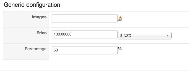

  • Posts: 82
12 years 6 months ago #147464
Regarding the above... it' s ok.. I realized how it works.
But I am not sure what these fields are for:
Generic configuration
Price:
Percentage:

  • Posts: 26386
  • Thank you received: 4078
12 years 6 months ago #147465
These fields are in all payment plugins.
www.hikashop.com/support/documentation/i...al-form.html#generic
