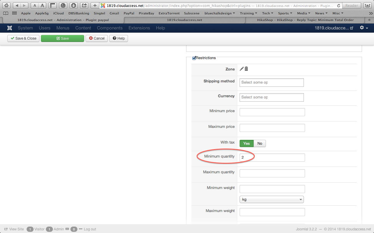

12 years 5 months ago #147216
In the payment method settings, in the restriction part, you have to set "2" for the option "Minimum quantity".

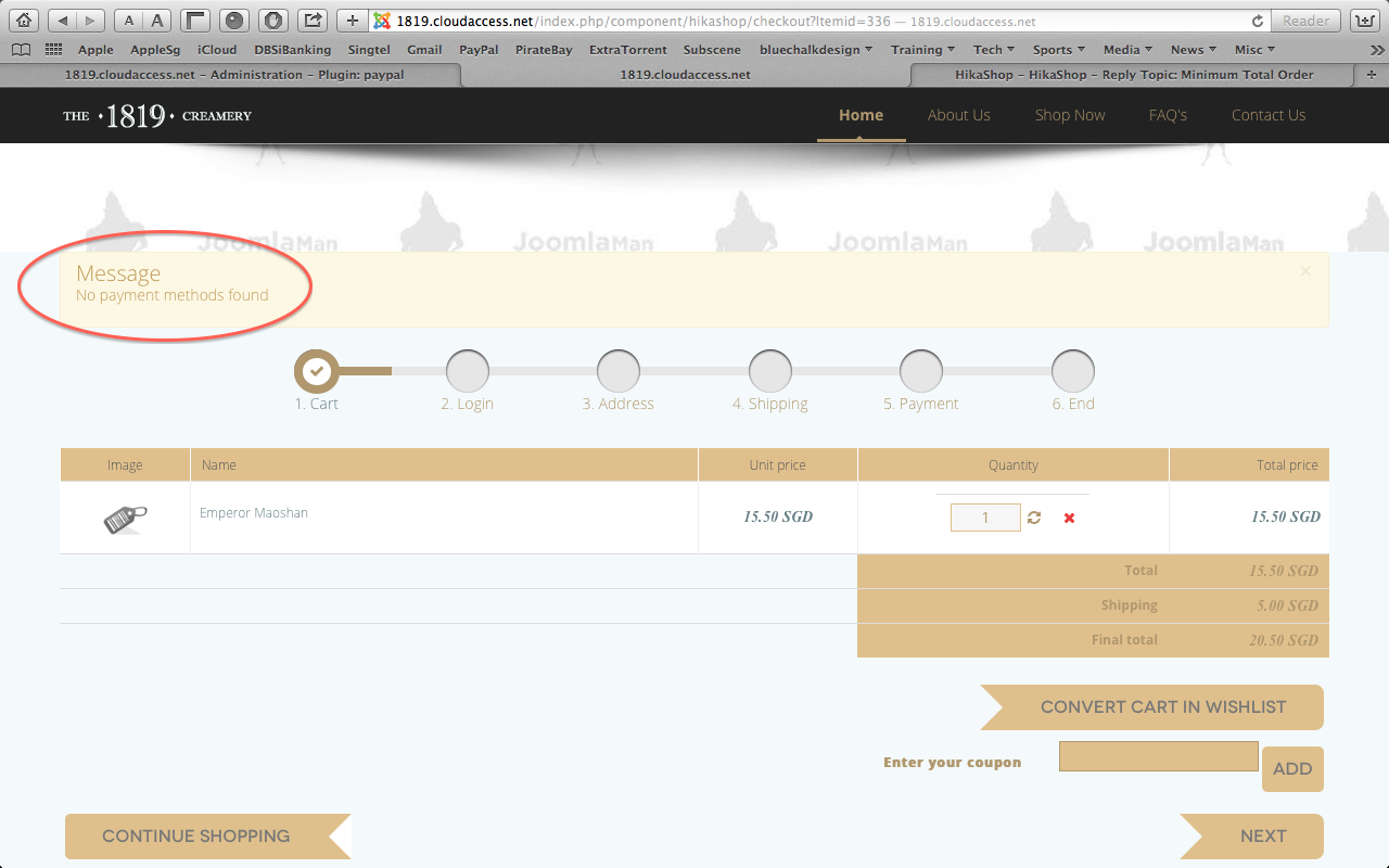

12 years 5 months ago #147428
I've set the "Minimum quantity" to 2 accordingly (Screenshot 1), but now I get a message "No payment methods found" on the frontend (Screenshot 2) when I proceed to check out.

12 years 5 months ago #147460
you set a restriction on the minimum quantity to 2.
But I see in your cart there you have one single product.
It is logical that your payment can't be used because you do not fill the quantity restriction.
You do not have enough products to use the payment method so the result is that there is no payment method to use.
So the message is displayed.
I do not see any kind of problem here.
If you put enough products in your cart, you will see your payment method !
