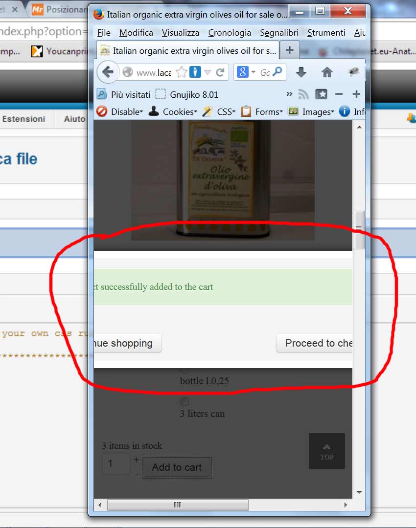

today i noticed an issue.
using a smartphone i noticed that the popup after the purchase goes over the screen.
You can see what i mean on my screenshot

You can edit the view "checkout / notice" to make it responsive. (if you have a responsive template).
And few css properties for that.
The css file to edit can be found thanks to the browser console, it's generally the main css file of your template.

It's more complicated, this popup have a fixed size which can be set in the hikashop settings.
The hikashop css file is not applied on that notice, but the responsive code can be put directly in the hikashop view.
So it require changes on the two sides. Generally the popup must be avoid for responsive websites as it's not supported by smartphones.

To set a different site, you can edit the value of the option "Add to cart popup size" in Configuration > Main > Cart.
You can too edit the view "checkout / notice" and edit your template css file to change the popup size in case of there is an override.
Else you can display a simple alert instead of the popup notice by putting some javascript in the view "notice" instead of the current content.

it was enough just modifying the "Add to cart popup size" to 280 x 200.
Now it is perfect on smartphone also!!!
It was so simple!!
