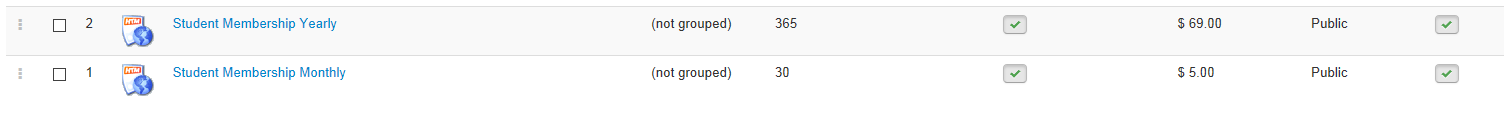

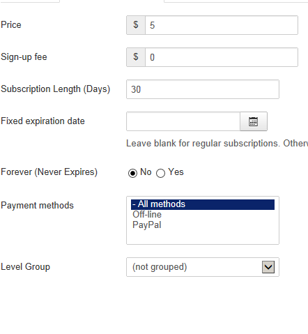

1) Go to Akeeba Subscriptions and add (1) 30 day product and (1) 365 day product (capture1.png). Make sure to set prices (capture2.png).

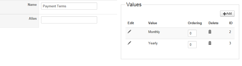

2) Add a characteristic (Product -> Characteristic) called "Payment Terms" and two values "Monthly" and "Yearly".( capture3.png, capture4.png).

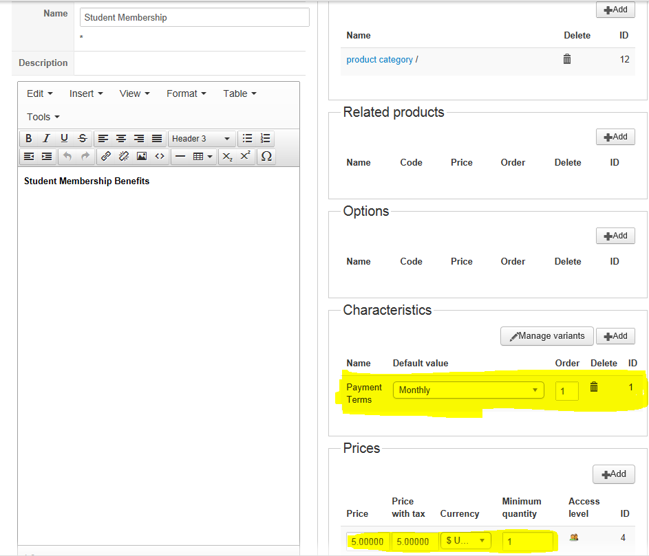

3) Add a product for your membership type, in my case "Student Membership". (capture5.png).

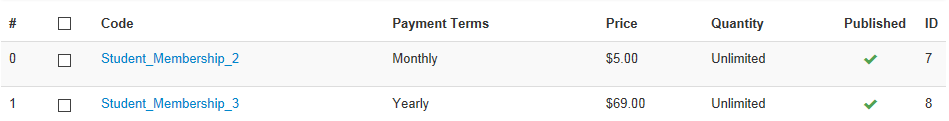

4) Add characteristics, set the default characteristic, in my case "Monthly", add the price for default (capture6.png)

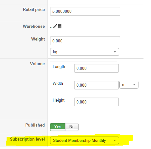

5) Make sure to pick the subscription level (capture7,png).
6) Click Manage Characteristics then click on a characteristic and (capture8.png).
7) Set the price and subscription level for each characteristic (capture9.png, capture10.png).

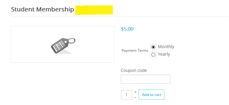

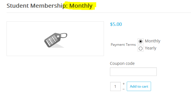

I do have one other question. After removing the retail price and setting the prices in Akeeba instead of Hikashop, it looks and works how I want it to work. The only problem is that the default variant name isn't displayed in the title when the product first loads. Is there a way to change that functionality?

12 years 3 months ago #155751
Yes you have to remove the code:
			if (hikashop_getCID('product_id')!=$this->element->product_id && isset ($this->element->main->product_name))
				echo $this->element->main->product_name;
			else
In the view "product / show_default" via the menu Display > Views.
