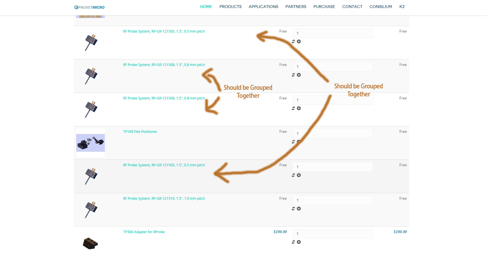

I noticed that when I add the same item more than once to the cart it displays seperate from other items of the same product. Is this a characteristic changeable so that all products of the same type are merged together.

I figured out the problem is due to the javascript code I used to add multiple items to the cart. The code uses the following url
http://www.demo.hikashop.com/index.php?option=com_hikashop&ctrl=product&task=updatecart&data[ZZ]=YY&data[AA]=BB&checkout=1
That will add YY items of the product with the id ZZ and BB items of the product with the id AA in the cart at the same time.
here is a page you can test that does not work http://www.inkacollective.com/testing/consilium/products/rf-probe
However, it does work when I am using the default TAG insertion extension which can be seen at this page http://www.inkacollective.com/testing/consilium/products/rf-probe
I am not sure how to adjust the URL to submit multiple items to the cart and also allow them to add to the same items already in the cart???
Thank You.
12 years 3 months ago #156900
The default url to add a product in the cart is:
<a class="hikashop_html_add_to_cart_link" href="http://localhost/j33/index.php?option=com_hikashop&ctrl=product&task=updatecart&quantity=YY&checkout=1&product_id=AA">Add to cart</a>.
It can be found in the product edition page by clicking on "add to cart url".
In this url, you just have to change the value for the "quantity", and the product_id to add multiple items at a time.
