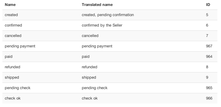

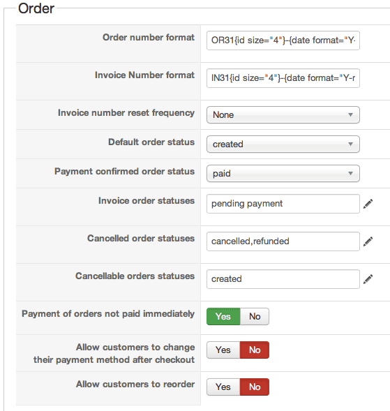

For whatever it's worth, I'm attaching here snaps of my order statuses and the "Order" config.
  • You can tell, the core "confirmed" status still exists, but for my workflow it has now become "confirmed by the Seller". No invoice gets attached there, and for me that's actually good! Even if you had intended for it to be attached there.
  • You might guess correctly that "pending payment" is the status where the invoice shall be attached (because in my case it's a proforma invoice). But I can't get that to work... :(
  • You might be just as surprised as me that "paid" is the status where the PDF invoice gets emailed, finally. But that's too late = bad. Only, I can't change it.

It seems indeed that you will have to edit the plugin directly.
In the function onBeforeMailSend(), in your case changing "order_confirmed_status" by "invoice_order_statuses" in order to attach only on emails with "pending payment" order status.
To not send it to the vendor, you can potentially add a check on "$data->mail_subject".

The change in the plugin went well - it works perfectly! No tweak necessary to prevent the invoice being sent to the vendor, because the PDF goes out only with the "pending payment" mail to the customer (which the vendor doesn't get), and not anymore with the "paid" mail (which is the first the vendor gets).
