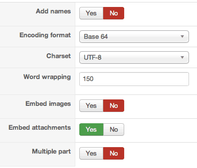

  • Just for the record, I am attaching my mail setup as far as you might think it's relevant. The present setup is what I want/need, I guess - but caution: the problems are totally NOT depending on these settings. I've spent lots of time to go through all combos of the switches, it's all the same. No worries, I spent longer testing and searching than writing this, haha.
