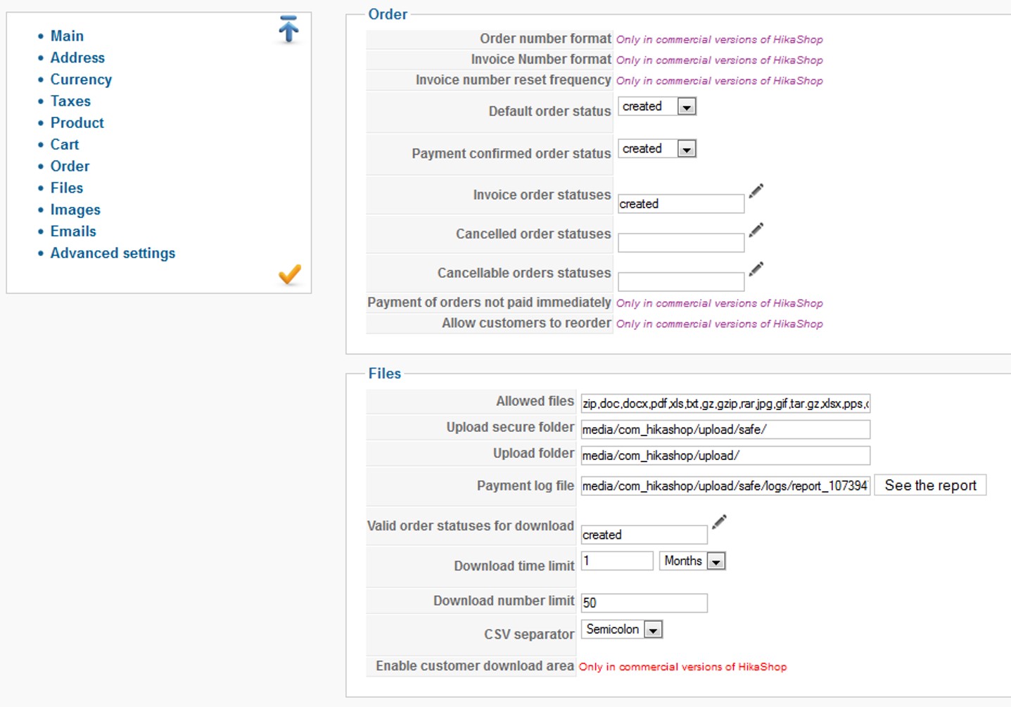

One more hint: What's your "Default order status" set to in the backend? Make sure it's "created", because by default that's the status where the admin gets the notification for a new order. If you set it to a later stays like "confirmed" or so, it won't happen unless you modified code.

12 years 2 months ago #158664
Thank you for the suggestion of changing "confirmed' to "created" but it still didn't work (see attached).

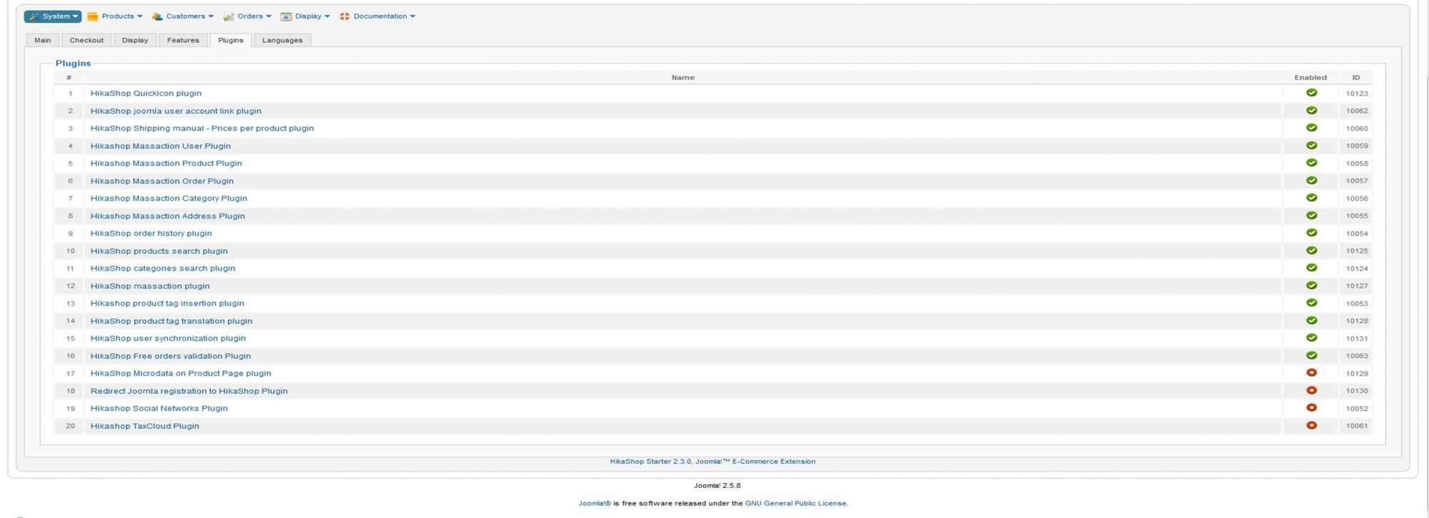

Is it possible that I am not using a plugin that I should be using (see attached)?
As for updating, it says I have the latest version. Would you still suggest I reinstall, and if so how do I do that to avoid losing all of the work I have done?

12 years 2 months ago #158667
The core mail functionality is already on board, no extra plugin needed or to be enabled.

12 years 2 months ago #158638
Thanks to use another value for the option "Default order status", value like "created".
This way you should receive the order created notification emails.
