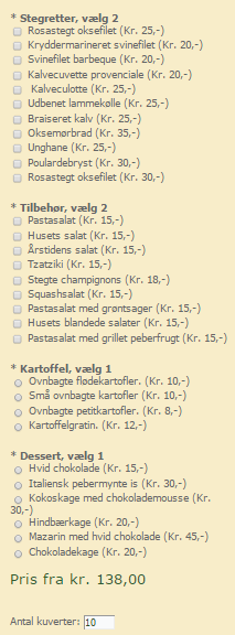

12 years 1 month ago #165969
I've been working with HikaShop Product options now. Just bought the essential package.
Can you please tell me if it's possible to add multiple options to a product with a heading for each group? And how can I do this.
This is what I'm trying to achieve. Options split into categories with headings.
www.kjaerskoekken.dk/34/115/buffeter/P-grill-selv-buffet.html

  • Troels83
  • Topic Author
11 years 10 months ago #176974
I've used most of the day working on the shop and trying to use the Custom Fields.
But it seems to me that when you create a custom field, it can only be assigned to an entire category, and not individual products inside a category, which is what I need.
And while options does add to the total price, the custom fields that I've made doesn't add to the total price. (See attachment).

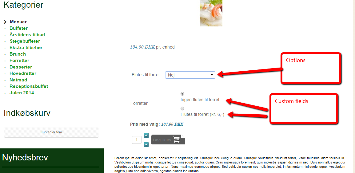

  • Troels83
  • Topic Author
11 years 10 months ago #177050
I see what you are getting at. In this way I can add checklist or radio fields from a custom field on a certain product. But that doesn't solve my dilemma.
---The important question---
I still need the option to influence the price., just like the dropdown on this page
kjaerskoekken.testprojekt.dk/index.php?o...alstilbud&Itemid=118
Admin: roi
Pass: roi
Inside a product I need groups of options for the customer.
This is a typical structure of what I need.
starter menu (This is the title)
(Options here)
main course (This is the title)
(Options here)
Dessert (This is the title)
(Options here)
Is this possible with hikashop?
See image below
Attachment not found

  • Troels83
  • Topic Author
11 years 10 months ago #177151
Hi Mohamed
Thank you for your answer.
Yes, I know that. But the issue is, that I won't be able to make groups with options.
If you see the picture from my last post, this is what I want to achieve.
If I use options, I can affect the price, but I can't make groups of options.
If I use custom fields, I can make groups of options, but I can't affect the price.
I just need to know if I can add options divided in groups that will affect the price. Just like in this redWEB shop www.kjaerskoekken.dk/buffeter/69/119/buf...din-egen-buffet.html
  • Posts: 86212
11 years 10 months ago #177180
No, there is no system to have checkboxes affecting the price. Custom fields can display checkboxes but can't affect the price and characteristics/options can affect the price but cannot display as checkboxes.
One thing you can do is have custom fields, and then develop a small quantity price override plugin to recalculate the price of the products based on the selection in the custom field.
That way, you can achieve that, but it requires some development.
