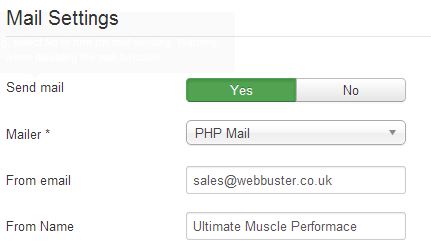

Your problem seems to be that the emails are not sent by your email server.
Please check the Emails settings of the Joomla configuration and of the HikaShop configuration with your hosting company so that they are set according to their requirements and then it will work.

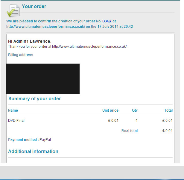

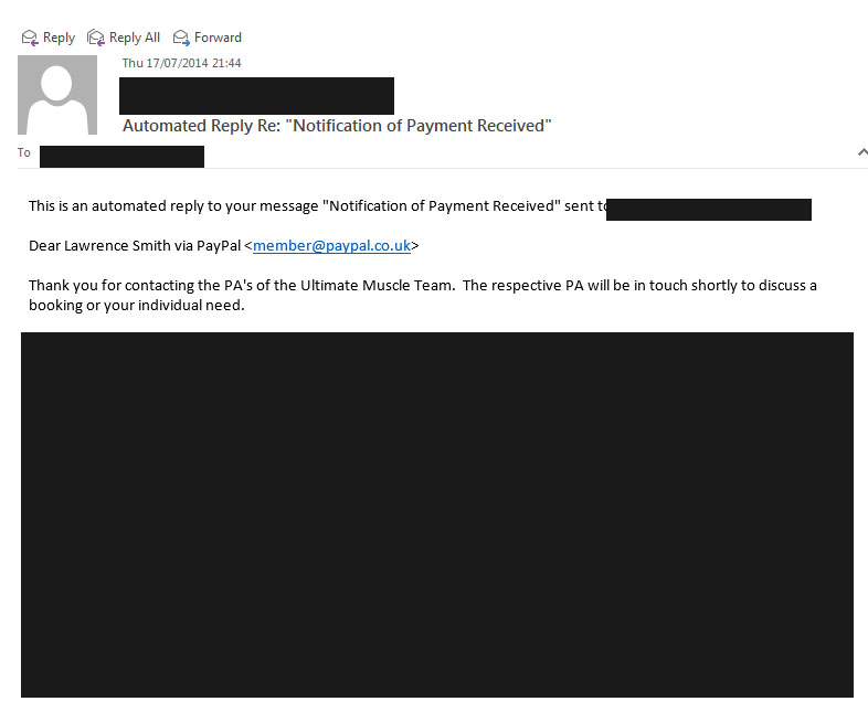

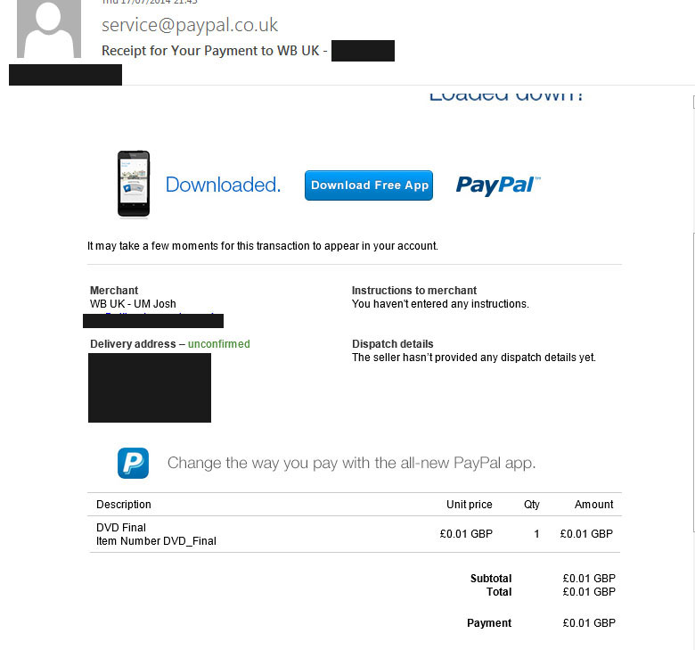

Not having any luck at all with this, I have taken two screenshots to show both emails are the same.
I received 4 emails, two to the email account that I'm registered to on the website and 2 sent to my email that is registered with my paypal
But I am still not getting a downloadable file
Emails sent to my account email
Emails sent to my paypal email

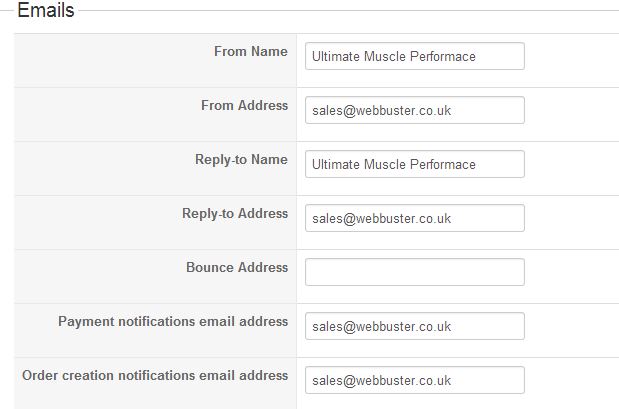

These are the details I have used in the back end
Please help, I'm tearing my hair out

11 years 11 months ago #164567
So from what I can see of your emails, that would indicate that the order has not been confirmed because no payment notification has been received from PayPal by HikaShop.
Can you check the status of the order in HikaShop ? Could you do a screenshot of the history area of the order ?
If the order is not confirmed, then you should check the different points presented in that FAQ:
www.hikashop.com/support/documentation/i...or.html#notification
