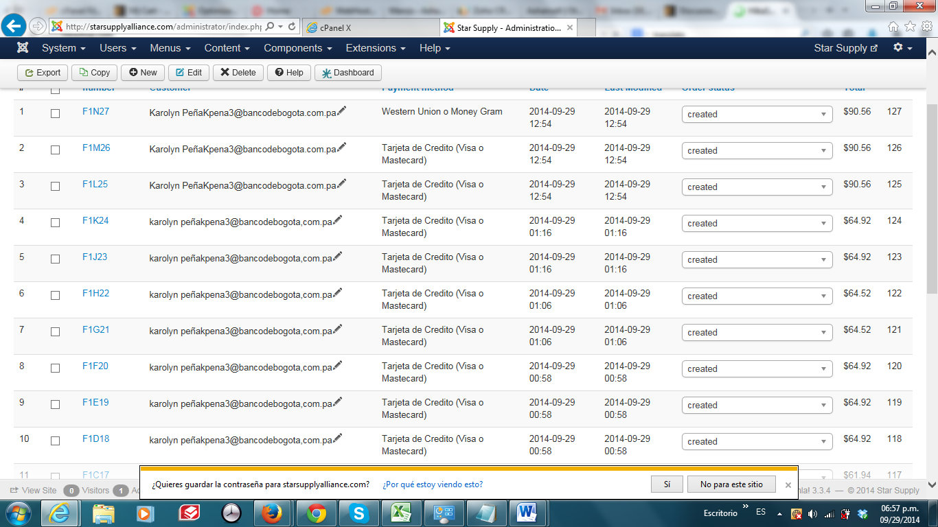

Please see attached screenshot.
What is causing this serios issue?

11 years 10 months ago #173666
The person tried to order multiple times and must have had some problems with his credit card or the payment gateway during the payment process.

11 years 10 months ago #173770
Hello Nicolas,
I think that I have worked out what is happening here. On the payment method screen the customer is clicking multiple payment methods while waiting for the Bank Transfer or ACH screen details screen to appear. This is causing multiple versions of the same order.

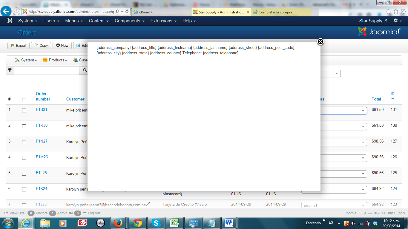

Also when trying to modify the redundant order to cancelled -using the drop down - to correct the stock control - I get this pop up screen (attached) and it is not possible to make the amendment without editing the order record- how do we configure the system to allow us to select from the drop down list

11 years 10 months ago #173772
Please re-download HikaShop 2.3.3, the issue you got is related to Joomla 3.3.4 and we fixed it end of last week.

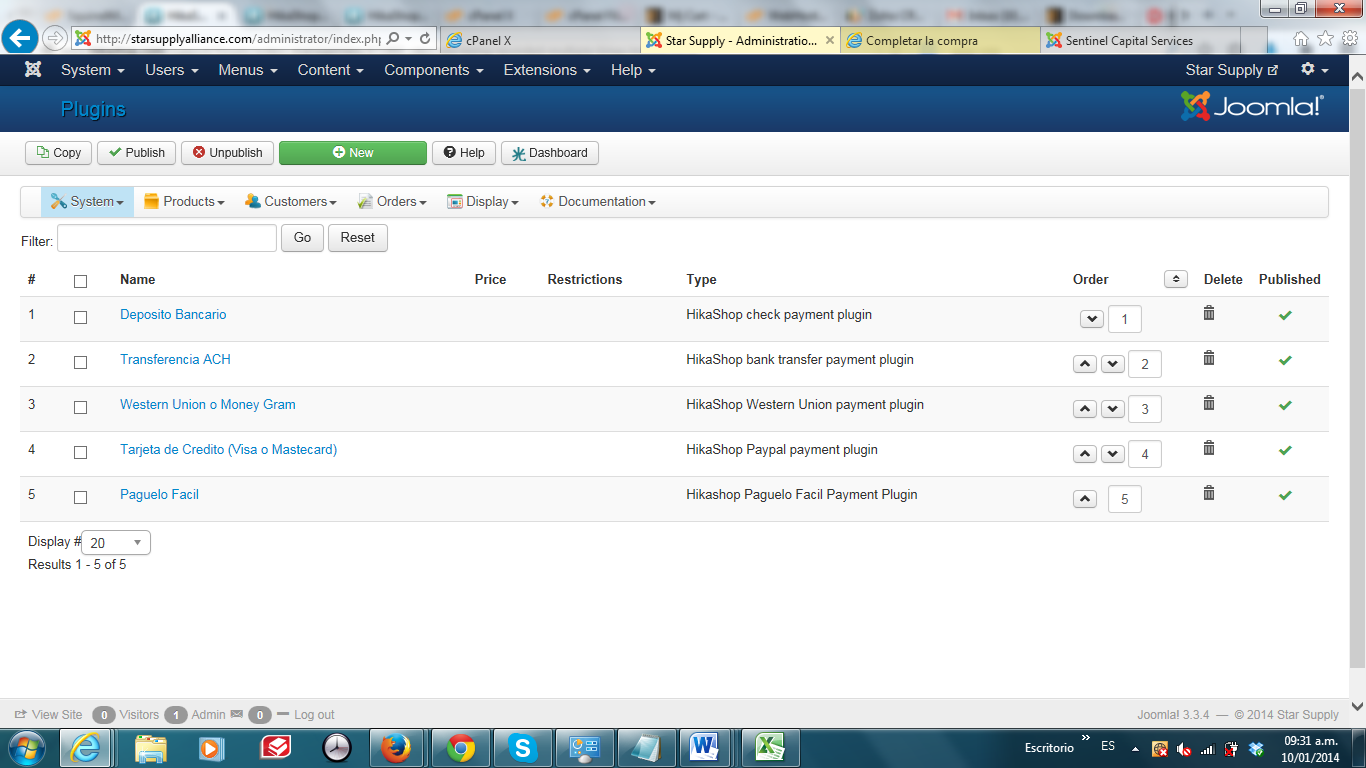

Regarding the types of payment plugins the problem is regarding your standard Western Union and Check plugins which we have not changed (see attached screen shot).
If you wish I can give you access to the test product where you can replicate the problem yourself?
Mike

11 years 10 months ago #174037
Try to change the line:
$checked.=' onclick="this.form.action=this.form.action+\'#hikashop_payment_methods\';this.form.submit(); return false;"';
to:
$checked.=' onclick="this.form.action=this.form.action+\'#hikashop_payment_methods\';this.form.submit();this.form.disabled=true; return false;"';
in the file "payment" of the view "checkout" via the menu Display>Views.
