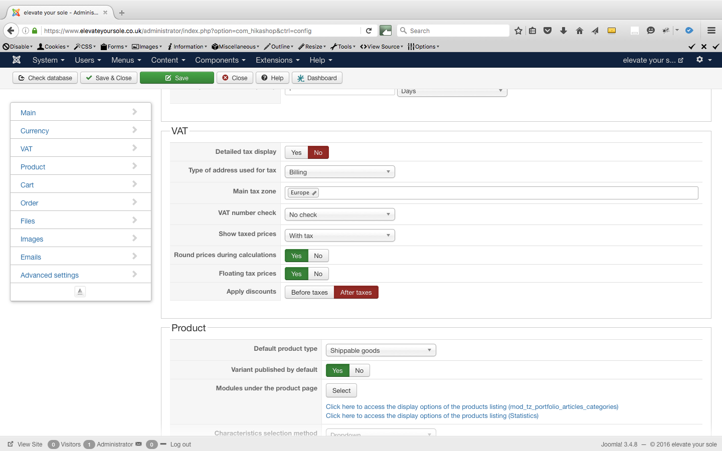

  • Posts: 265
10 years 4 months ago #235674
The option is activated in the system configuration, please see attached screenshot. I'm running Hikashop 2.6.1, which I believe is the latest stable version.
The information about the order is private, so I'm not going to share this on the forum. I could send you a private email.
One of the latest 'refusals' was for this product: www.elevateyoursole.co.uk/all-womens-sho...lackleathershoeboots
All my products have VAT added (Tax rule) and the shipping method chosen was "Free UK delivery". No coupon was used, although it is a sale item.
The payment came through correctly at £48.99, which is to be expected. The problem comes after this: "A Paypal notification was refused because the amount received (48.99GBP) is different from the order amount (49GBP)". It then displays as 'cancelled' in my order book.
