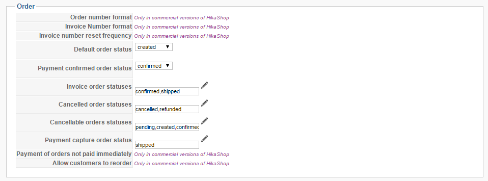

  • Posts: 8
11 years 7 months ago #180802
Here is the screenshot.
  • Posts: 85836
  • Thank you received: 14094
11 years 7 months ago #180820
The system uses the "invoice order statuses" to know if it can give back the stock.
Add "pending" in that option and it should work.
The following user(s) said Thank You: suatcamillo
  • Posts: 8
11 years 7 months ago #180923
It worked! Thank you for your help. I think you can close the thread now. :-)
