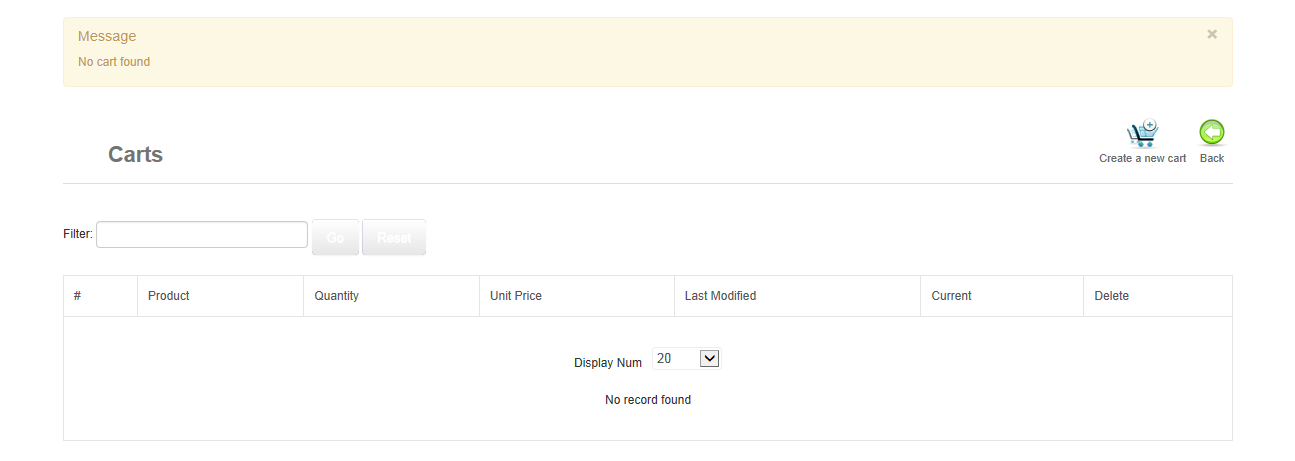

Hikashop mistakenly displays a no cart found item when the last item is deleted from the cart/showcart.php view.
This requires a menu item to display the cart in the cart/showcart view.
The following sequence is required to produce the error:
a) add a product to the cart
b) log out
c) log back in
d) go to cart/showcart via the menu link
e) remove the product(s) until the cart is empty
The system then displays the "No cart found" message (please see attached).

11 years 8 months ago #184093
This is a session issue, while in the session the cart is kept even if it's empty.
But as soon as you log out, so there is no more cart stored in session so when loggin back it display the message because there is indeed no more cart attached to the customer.

11 years 8 months ago #184095
Thanks, Xavier.
I can't make sense of your response in light of the configuration, though. You mentioned that this is a session issue and that "as soon as you log out, so there is no more cart stored in session". However, in Hikashop we can configure the Cart retaining period to x number of days. Hence, when we log out and log back in, Hikashop remembers the items that have been ordered but not yet confirmed.
It just seems that Hikashop retains some information but not the cart ID (which I think is the most important bit of info).
Please could you shed some more light on this?
Thanks.
Take care!
11 years 8 months ago #184099
Hmmm in the showcart view, we get the cart id from the session as in any other views.
More debug on the showcart function of the "components/com_hikashop/views/cart/view.html.php" file will be required.
Checks near the line:
		$cart_id = JRequest::getInt('cart_id','');
		if(empty($cart_id) || $cart_id == 0){
			$cart_id = $app->getUserState( HIKASHOP_COMPONENT.'.'.$cart_type.'_id', 0, 'int' );
			if($cart_id == 0){
