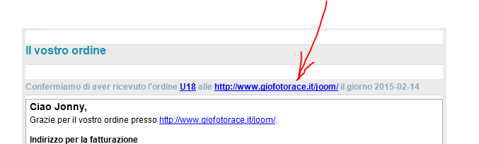

Buongiorno is a mistake in the order confirmation email, which should bring the time when the order was placed back on the site, as can change this value?
  • Posts: 86178
  • Thank you received: 14214
11 years 7 months ago #190719
This URL comes from the "live site" option where you set the URL of your website in the Joomla configuration page.
  • Posts: 55
11 years 6 months ago #191178
The problem is that there should be them the time and not the site link

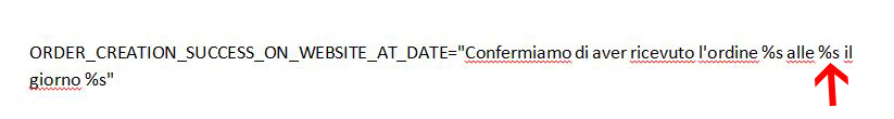

These are the translations in Italian and English of the problem, the variable is not a link to the site but a time, for example at 18.45 not www.pro .....
Italian: ORDER_CREATION_SUCCESS_ON_WEBSITE_AT_DATE="Confermiamo di aver ricevuto l'ordine %s alle %s il giorno %s"
English: ORDER_CREATION_SUCCESS_ON_WEBSITE_AT_DATE="We are pleased to confirm the creation of your order No. %s at %s on the %s at %s"
How do I change that variable?

11 years 6 months ago #191395
There should be no need to change any code.
Just modify that text with a translation override so that it displays what you want:
And if you want to change the order of the variables in the translation, it's possible too.
So for example the translation:
in the same as:
ORDER_CREATION_SUCCESS_ON_WEBSITE_AT_DATE="We are pleased to confirm the creation of your order No. %1$s at %2$s on the %3$s at %4$s"
and you can change the order of the variables like this:
ORDER_CREATION_SUCCESS_ON_WEBSITE_AT_DATE="We are pleased to confirm the creation of your order No. %1$s at %2$s at %4$s on the %3$s"
