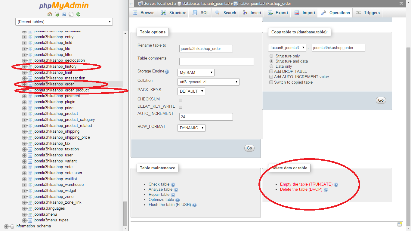

  • Posts: 220
11 years 2 months ago #205627
"It's not that complex. Just go in your phpmyadmin and click on the "truncate" or "empty" button for the tables hikashop_order hikashop_order_product and hikashop_history and you should be fine."
Where is phpmyadmin?
Also, you should put those about 1 year usable wordings on the product description before we pay. Not only on the page after we pay. That's why I feel being cheated! There is reason!

  • Posts: 220
11 years 2 months ago #205696
I want to make sure again, I just need to click"EMPTY" , NOT "delete" the TABLES below:
hikashop_order
hikashop_history
Correct ?
Last edit: 11 years 2 months ago by clairewang.
  • Posts: 86180
11 years 2 months ago #205711
Yes. You want to empty them, not delete them. If you delete the tables HikaShop won't work properly and you'll have to click on the "check database" button of the HikaShop configuration in order to add the tables back.

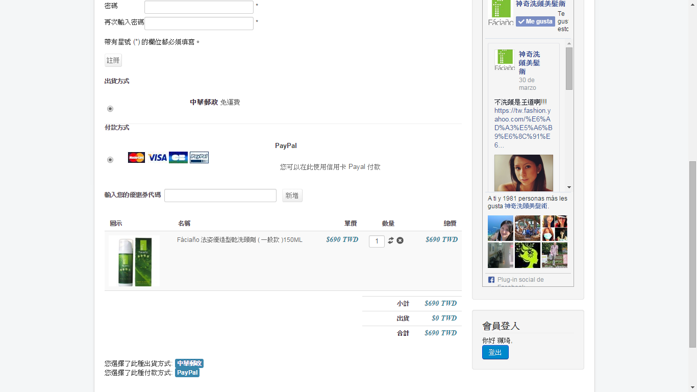

  • Posts: 220
11 years 2 months ago #205816
Thank you all. Okay, I empty the records, and the previous problem happened again. People who new logged on can't click "next step" to finish the order. I need to reinstall your hikashop free version always. I had reinstalled at least three times before.
Can you fix it?
  • Posts: 220
11 years 2 months ago #205819
Okay, I am pretty sure now, even I reinstall the free version and the Essential both, the new register still can't click the NEXT STEP to finish the order. Please help to solve it. Thank you a lot.
The process-- people choose new product to the shopping cart---->sign up as a register----> click back the email confirmation link-->keep asking the password for signing up---> No NEXT STEP to move on...
